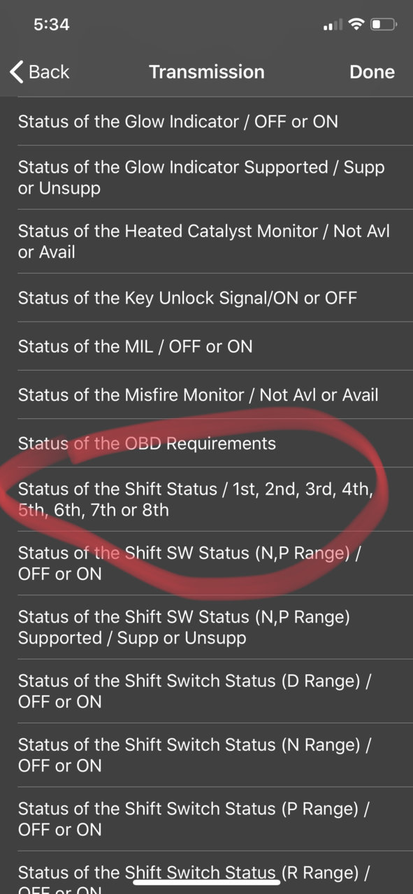

    There is NO Toyota PID for Tacoma oil pressure, nowhere at all, doesn’t exist... sumbitch engineers..!
    EDIT: current gear selection is “Status of the Shift Status”

    Looking at the pic I am really liking the idea of trying the pid right obove the status of the shift.
    I am hoping it uses a status of 1 thru 5 for normal,misfire , continous poor combustion and so on . Maybe it can be an indication of weather I am getting true misfires or false triggers from rough roads or a torque convertor problem .
    Has anyone tried it ?
    Edit - UPDATE I tried it out this morning and the gage stayed on 0 the whole drive. I had misfires and it did not react to them .

    I’ve never seen anything other than 0 on the PID. Then I look under monitors and see misfires. I’ve heard that the PID resets to 0 after a short while, but again, I’ve never seen anything other than 0

    I can’t get the gear to show properly. Mine is status of 1,2,3 etc

    That's the right PID, works for me. Try disconnecting than connecting again.
