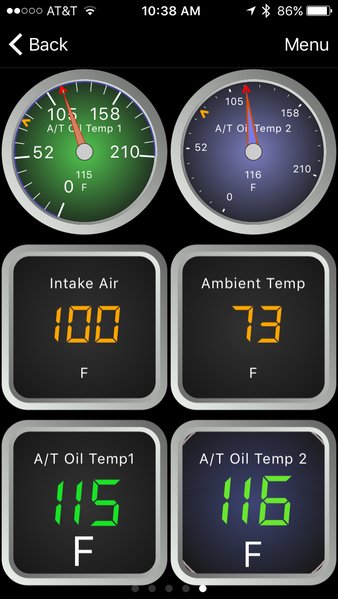

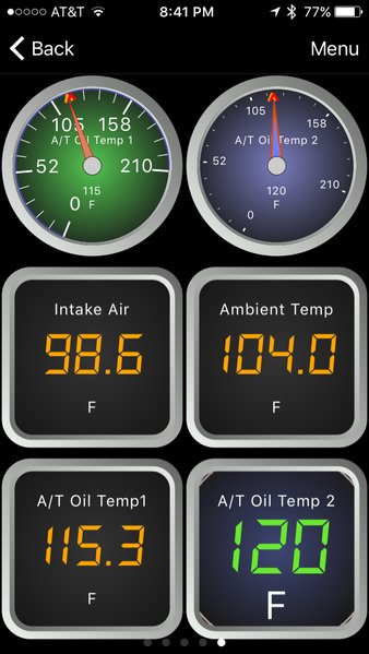

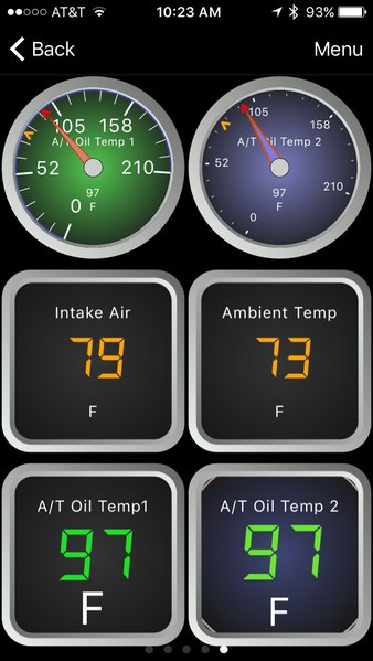

    i just install a kiwi3 w/ obd fusion and the toyo enhanced diagnostics add-on (Toyota custom PIDs). So here's my review of the first 5min of use...
    Kiwi3 - The Kiwi3 is one of the few wireless scan tools that will connect via BT with the iphone without having to jailbreak and thus the reason for the $100 price tag.
    The kiwi3 connected instantly to my iphone via BT - did not even have to open the BT settings or BT pin numbers. The unit is lightning fast. Data is updated instantly with no delays.
    obd fusion - The dash board is feature rich and easy to use. the enhanced diagnostics has hundreds of Toyota's custom PIDs including the tranny temps. I'm very pleased with the setup.
    Cost $120
    Kiwi $100
    OBD Fusion: $10
    Toyota Enhanced Diagnostics (OBD Fusion in-app purchase): $10

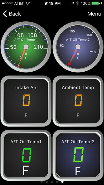

    update: I compared the fusion's tranny temps to the OEM paperclip a/t temp check mode and fusion was dead-on. the oil temp light came on at 97F and started flashing at 115F. So fusion has cracked the nut for sure.
    well worth the money after reading all the post about accuracy concerns with the custom pid formulas floating around.
    There are two tranny temp PIDs in fusion. the oil temp light on the dash is synced with the funsion's tranny temp 1 pid. The tranny temp 2 was always 1F ahead of temp1 for an idle warmup.

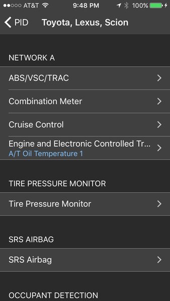

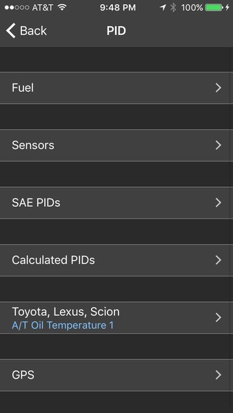

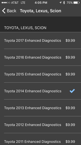

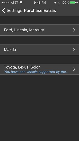

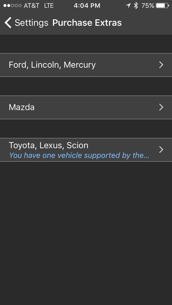

    The Toyo PIDs are not in SAE PIDs
    The Toyota PIDs are in a separate list. "Toyota, Lexus, Scion", see pics below.
    A couple things to check to make fusion has id'ed your truck.
    I assume u have connected & fusion has ID'ed u truck?
    Do u see "you have one vehicle supported by..." in settings under extra purchases on the "Toyota, Lexus..." menu? See pics below.

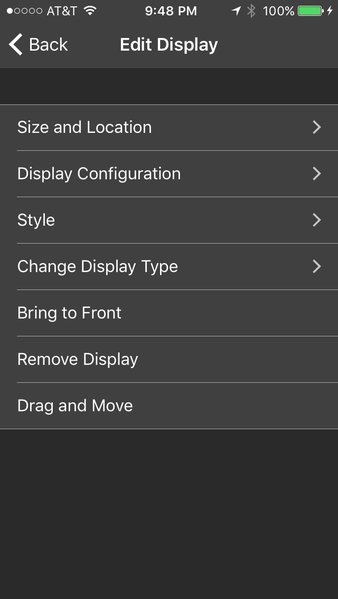

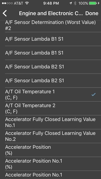

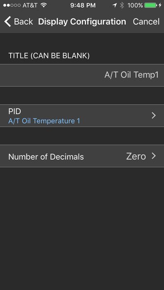

    Select dashboard, select any gauge, select display configuration, PID, Toyota..., engine and..., scroll down to see Tammy temps

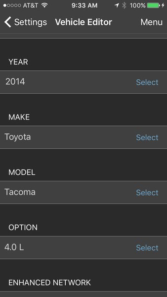

    Do u have the engine selected on the "option" tab. This is a manual entry.

    So that worked. Under that option I had "Access Cab", when I selected it again and picked "4.0L" the enhancements showed up. Can't remember where Access Cab came from.
    Thanks so much for the help.
