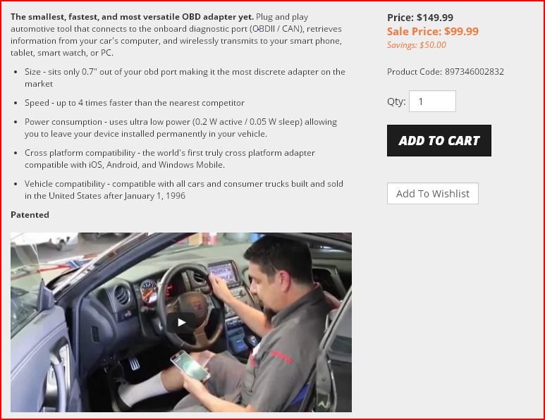

    i plan to once i get my dashboard setup. according to the oem it has a .05w sleep mode and is designed to leave plugged up.
    PLX - "Power consumption - uses ultra low power (0.2 W active / 0.05 W sleep) allowing you to leave your device installed permanently in your vehicle".
