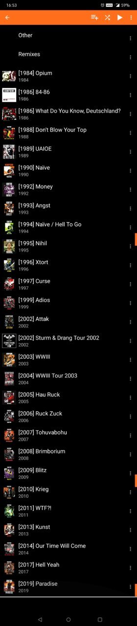

    I couldn't give up KMFDM. I did have to exclude several FLA albums and weeded though other albums where I only liked a song or two.
    This is what I have for KMFDM. I have the flash drive synced with my phone. I edited the album tags to include the year since Entune seems to ignore the date tag.

    Nice, but you're missing Apart. :cool: LMK if you want MP3s. IMHO, everything after Angst is ho-hum. There's of course a few good tracks in there but I can live without all their "newer" stuff. That said, I have ALL FLAs stuff on my thumb drive. I don't think I can think of a more consistently good band. And Rhys Fulber's new solo stuff is also really damn good. Industrial/Electro/EBM is easily my favorite genre...

    I'm curious about that "84-86" you got.
    Here's my KMFDM stack:
