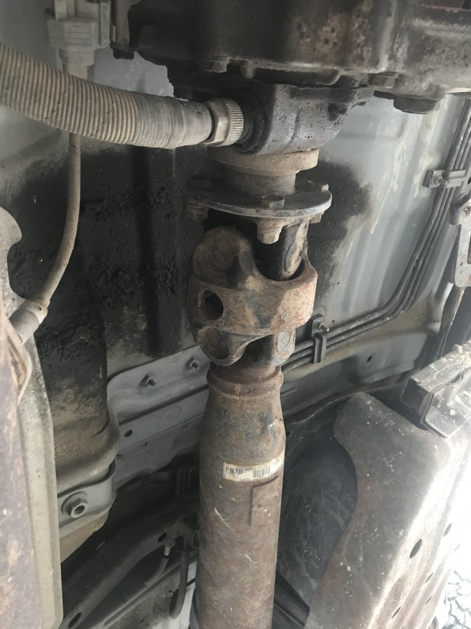

    Standard cab or ? Standard cab doesn't have a carrier bearing if I recall.

    Sound isn't fast enough for a driveline to be causing the noise. It appears to be with wheel speeds.

    Yes standard cab... I’ll jack it up on the front crossmember right now and see if I can recreate anything

    Would a u joint possibly make that noise?

    Id think so

    Driveline can. But it's spinning 4 times faster then a wheel. In the video he posted the sound isn't that fast.

    Thanks, was thinking the same thing, but wanted to eliminate it completely.
