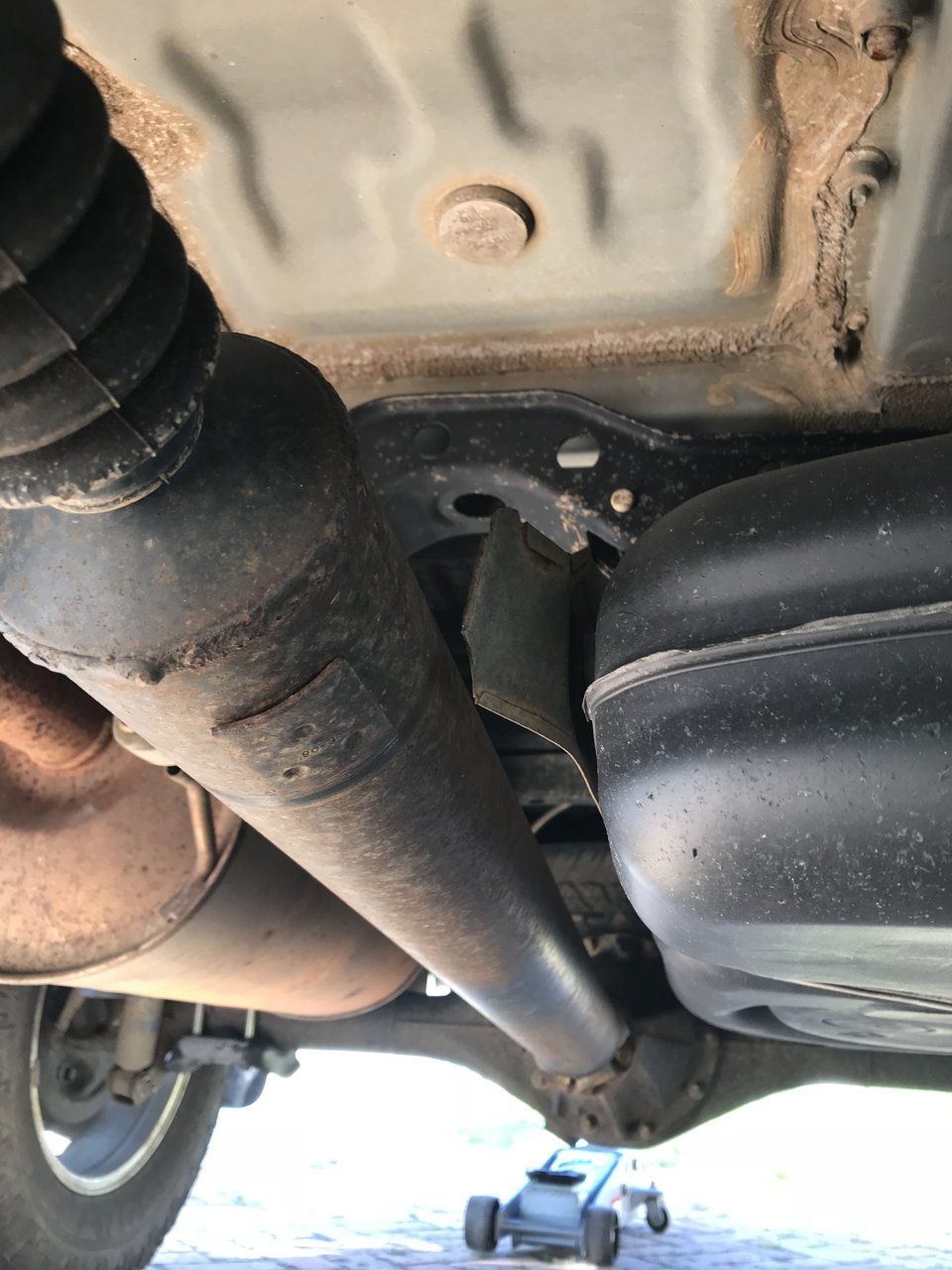

    I've started to notice a sound like a piece of sheet metal making a rattling noise coming from the right rear of my 06 OR. It only seems to happen in 1st gear under moderate to heavy acceleration, or when towing a trailer. I'm wondering if it could be a heat shield on the exhaust system tapping something when there's enough of a load on the drive-line. The sound seems to be consistent with wheel/drive-line speed. Is there anywhere that a loose piece of the heat shield might be barely touching the drive shaft or even a U-Joint?
    I even thought I might be a random piece of tin touching the tread on a tire, but nothing seems to be close enough to any of the tires to make that happen. Any ideas??

    There are a number of heat shields under the truck. Get under there and wiggle a few of them. Cat converter heat shields are notorious for this problem after rusting a bit.

    Check the gas tank heat shield.

    THAT looks promising...
