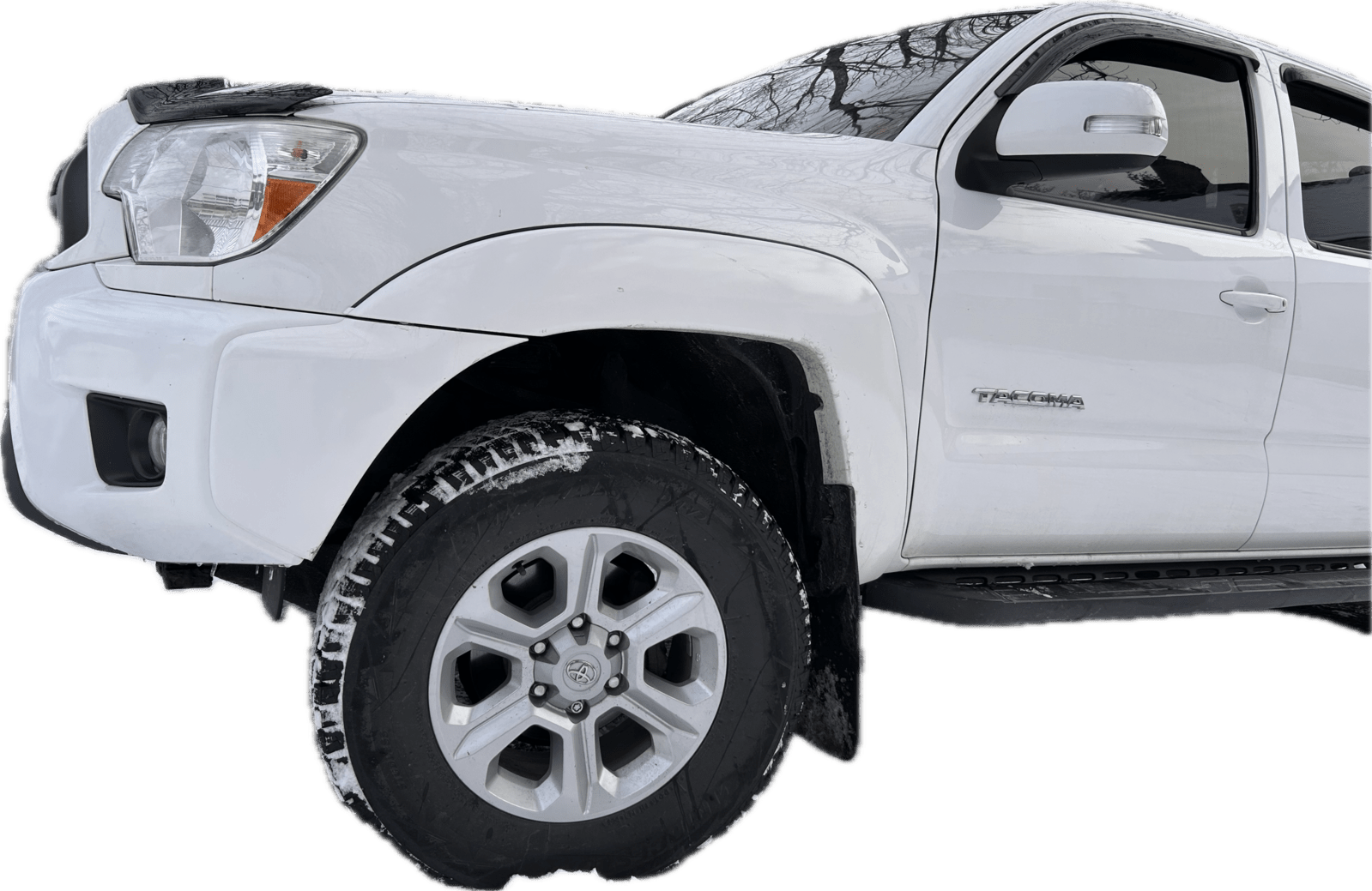

    I had those same wheels on my '15 for a while before they migrated onto the 3rd gen T4R. Nice looking wheel on a 2nd gen Taco. You can stay "skinny" by going with a 245/75/17.

    That truck looks just like mine! Same color and everything!

    i call them my winter blades with Blizzaks in 255 70 17
