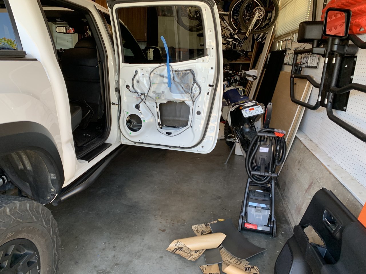

    Don't do what I did! Installed my OEM+ speakers this weekend. After installing the first speaker (rear door) I put the door panel back on then shut the door. I soon discovered that I incorrectly reconnected the lock and handle pull cables. I couldn't open the door no matter what combination of handles and lock buttons I tried. No big deal, just take off the panel and fix it, right? Not so fast. When the door is shut, the panel is against the frame and can't be removed. After trying various ideas to reach the cables using wires - all unsuccessful - I resorted to removing the door hinges thinking I could swing the front of the door out suicide style to get the panel off. The hinges alone aren't enough to free the front of the door completely but it was enough to move the door a bit (<1") away from the door frame so I could yank the panel off inside the truck.
    My bonehead mistake was corrected in about 10 seconds after a couple hours of scheming. Live and learn. The other doors went quickly and were fully tested before closing.
    The speakers are a great improvement already! ...and I still need to install the amps and sub.

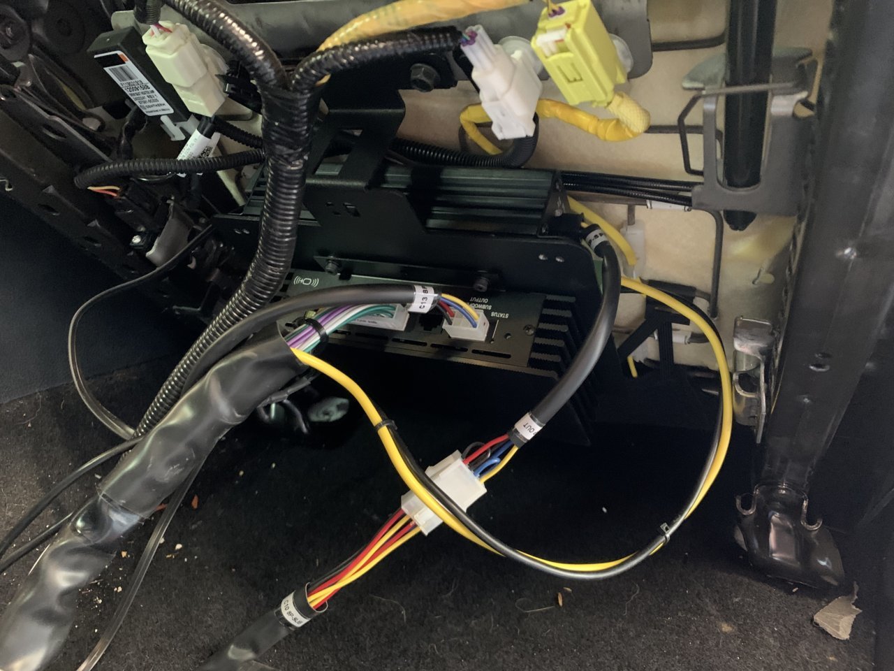

    Finished the install of the Reference 500 + dedicated sub amp. (1 sub). Also added sound deadening in doors and rear. What a difference this system makes! I am impressed. If you're on the fence, go for it!
    I can't compare to JBL because my TRD OR manual didn't have it. (Little known fact: you can't get the JBL in the manual OR; at least in 2019 you could not). And, I can't compare with any home-designed system. But, this sounds great and the fit and integration into the truck, wiring, etc, makes installation very easy.
    Pic because you need a pic, right? Amps under seat.
    patdeezy and svermilyea like this.
