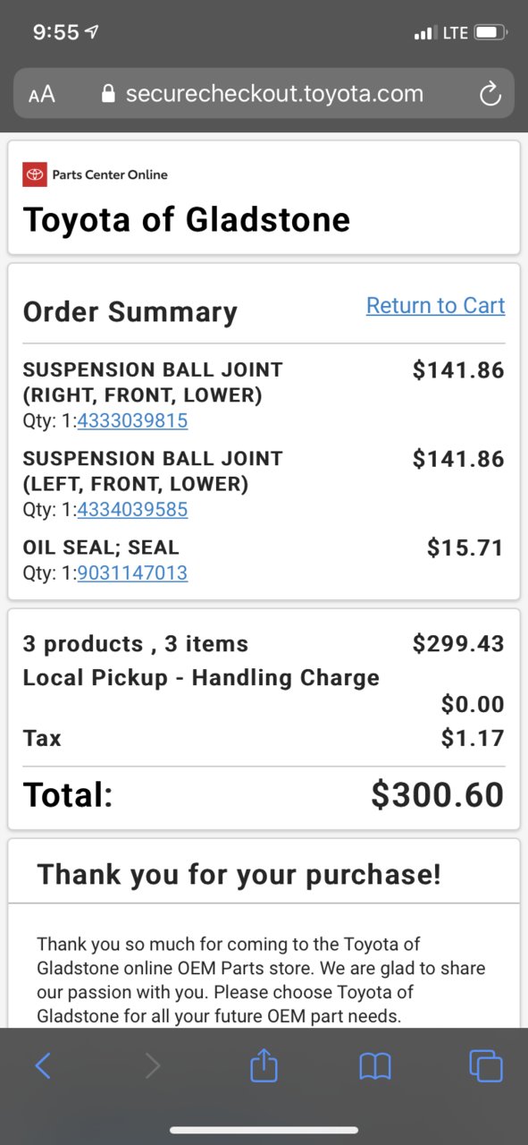

    I think I got pretty good pricing for my lower ball joints. I called the dealer and they quoted me $240 each. Went online and they’re already cheaper checked around some other dealers website and they were all different pricinghI think I got pretty good pricing for my lower ball joints. I called the dealer and they quoted me $240 each. Went online and they’re already cheaper, checked around some other dealers websites and they were all different pricing. Never would’ve thought different dealers parts websites would have different parts pricing with free pick up :thumbsup:

    To people who need front lower balljoints, see if you can order part number 04005-03235, it is a set of RH and LH for 1995-2004 Tacoma that was used in a recall. It works out to less than $100 per ball joint from some online dealers.

    Doh. $186.46 for the set.

    Also, anyone know the P/N for the four bolts that hold the LBJ on? I can't seem to find them in any of the diagrams online.

    I would use 90119-10933 for the bolts, sold individually.
    They don't come with the kit.
