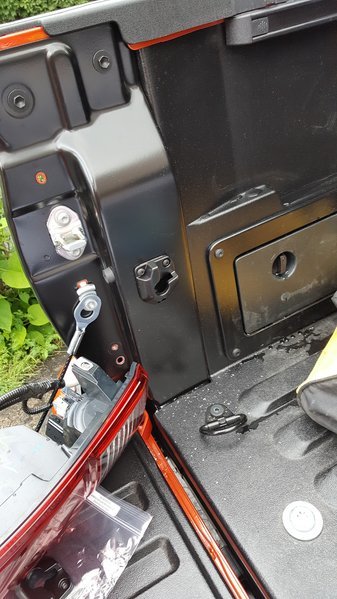

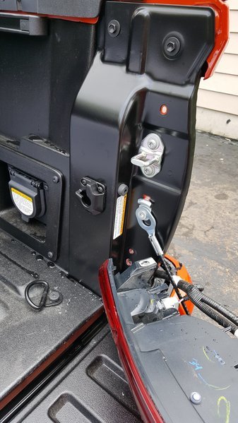

    Step 1 : Take off the taillights
    There are 3 10mm bolts holding each of the taillights on, after unscrewing them simply pull the lights off, keep it mind it may take some force, as they are held in by clips, but dont worry they wont break (dont try to hulk it either though, i pulled the bottom first and then the top)
    [​IMG][​IMG][​IMG]

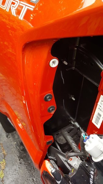

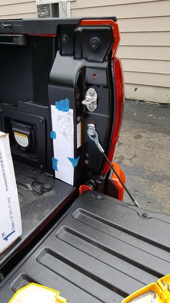

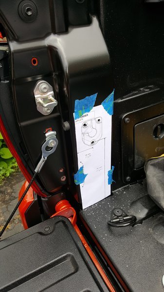

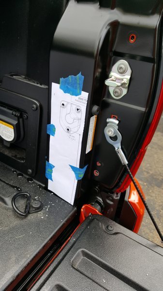

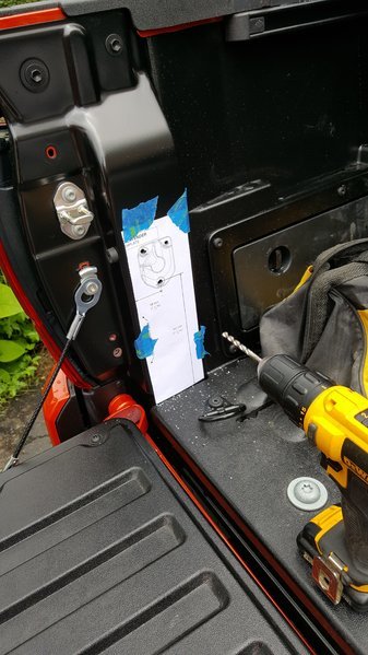

    Step 2 : Attach the templates to the pillars and drill some holes
    Just cut out the supplied templates, get some tape, and align the template with the bottom of the sheet resting on the bed liner, and the inside portion of it being right against the curved part of the D pillar near the tailgate. After doing this for both sides, either use a centerpunch to make drilling a little easier, or just go to town right away, i used a 7/32 drill bit instead of a 6mm one, you can get away with a 1/4in bit too. (also just make sure the template is properly scaled, just match the bracket to the picture on the paper)
    [​IMG][​IMG][​IMG][​IMG]
    Step 2.5 : Make sure the holes work with the brackets
    Self explanatory... make sure the brackets fit before doing anything else..

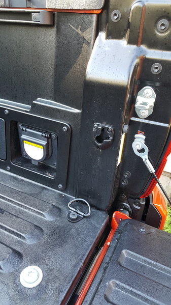

    Step 3 : Protect the drilled holes
    This step isnt necessary, but takes no time at all and will pay off if you live in the NE or anywhere where they salt the roads ever.. I personally used some clear coat spray instead of paint, but anything that will seal up the drilled area works... i also taped the area around the holes off since i was spraying the clear coat so i wouldnt make a mess... after spraying wait 30 mins and go assemble the extender

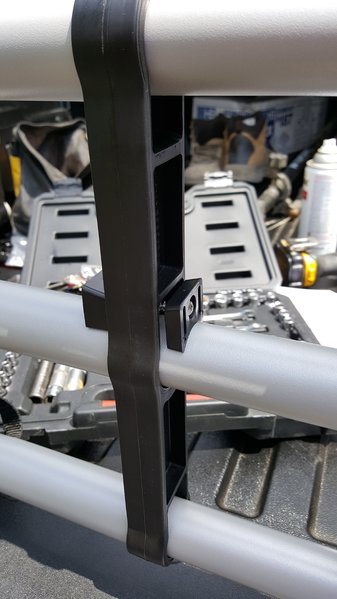

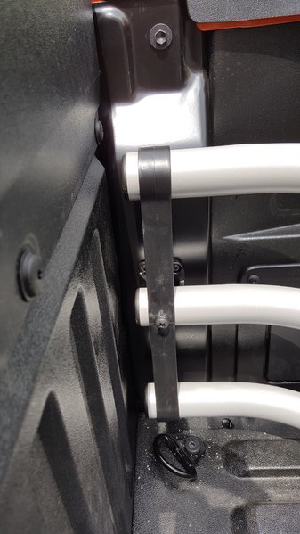

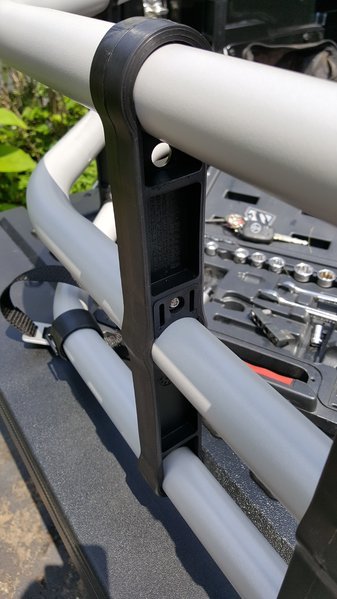

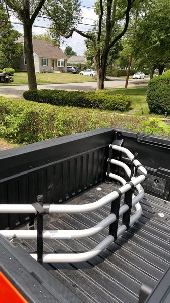

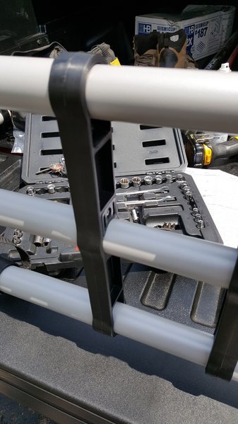

    Step 6 : install the bed extender
    the directions were clear enough in the manual, and its a straightforward install.. just make sure to install the tighteners on the center 3 posts. when tightening the block things make sure to do it flush with the plastic post...
    [​IMG][​IMG][​IMG]
    Thats pretty much the entire install, takes a half hour, maybe longer depending on how distracted you get... just make sure to have all tools before you start this.

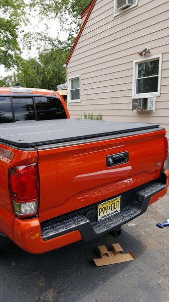

    The extender fits perfect under the tonneau cover the truck came with as well.
