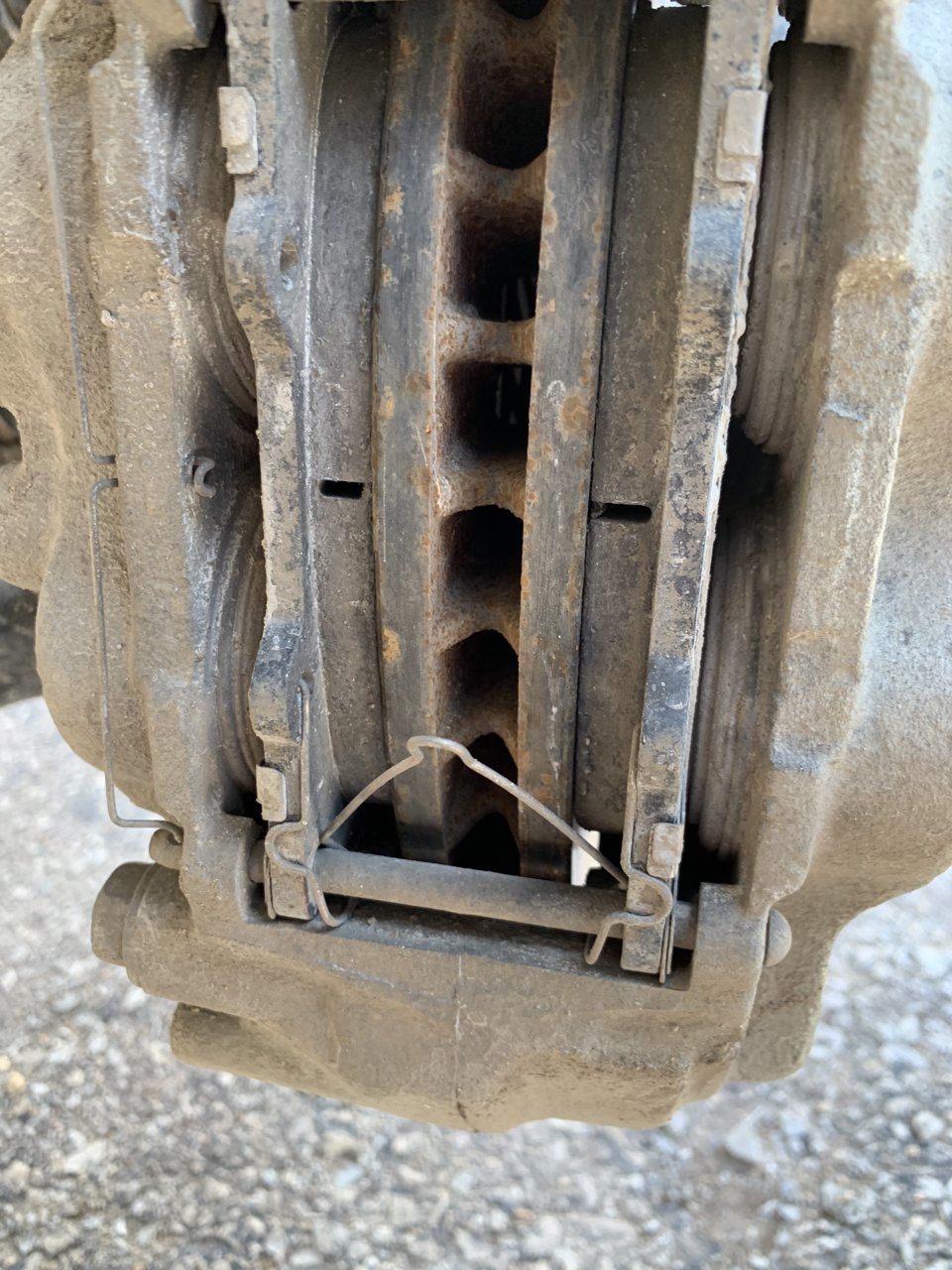

    Here’s mine with 85k miles

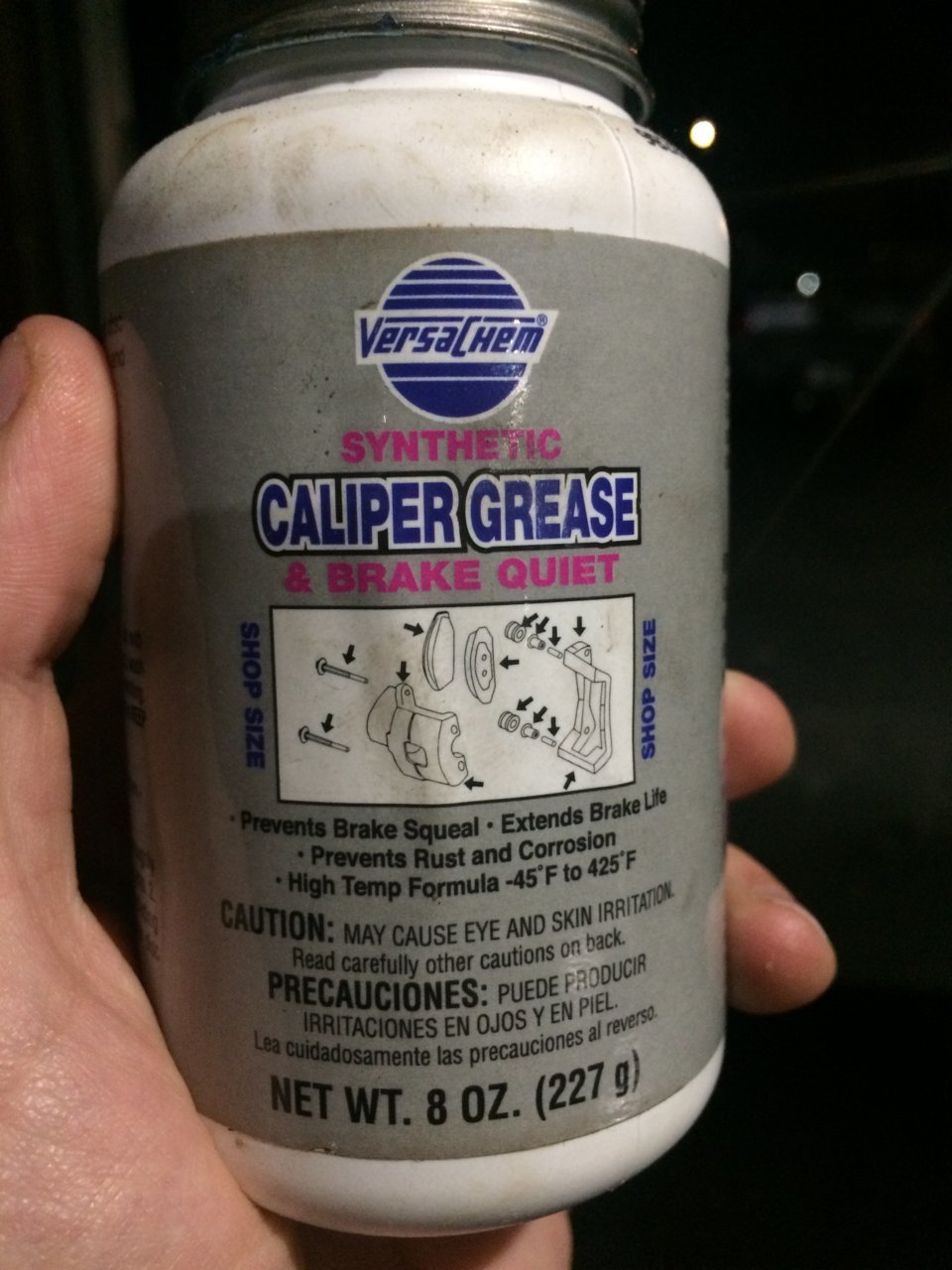

    Any lube you recommend for that? Looks like a lot of googling in my forthcoming.

    IMG_6028.jpg For grease this is what I use, and I've had great results and it reduced my brake pad shift noise

    Plenty of meat left.

    That purple ceramic shit works pretty well.

    Mine look very similar at 60k with a manual. At this point I wouldn't be surprised to go 150k on these..
