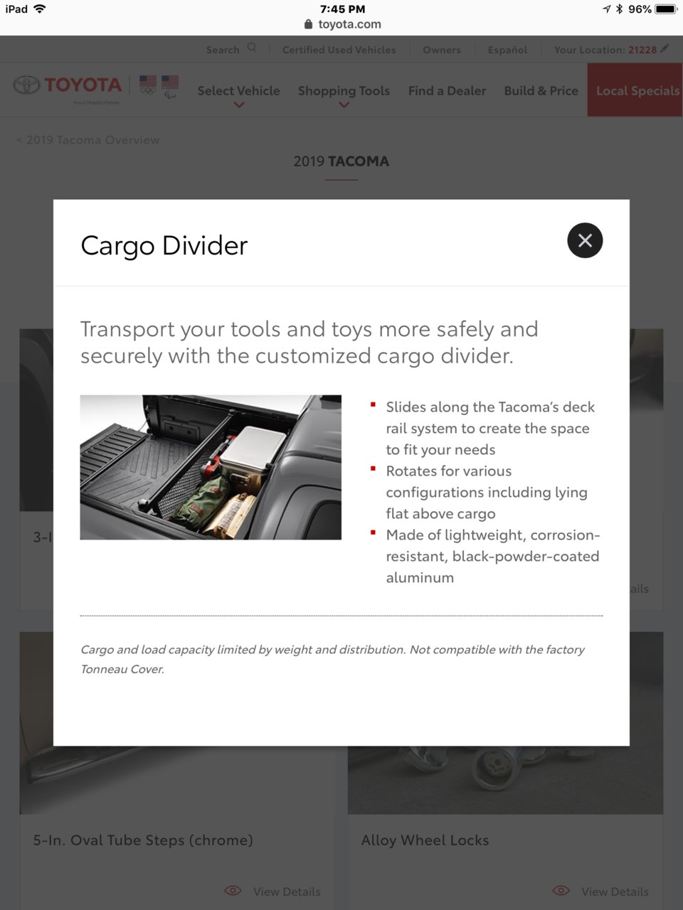

    Hi - I have a 3 fold Tonneau cover on my 2018 Tacoma. I'd like to get an OEM cargo divider
    PT767-35162. Does anyone know if the divider can be used under the Tonneau cover? I thought I read somewhere that it would work if you install the tightening knobs from the bottom instead of the top.

    According to the site, not if they're both OEM. I have the tonneau on and was wondering the same thing.

    Thanks Boyitz. This is what made me skeptical to the OEM divider hence my question to all the Tacoma blog peeps. But then I found this from another Tacoma blog...sorry I'm new to this, otherwise would direct you to it. But pfairhur with a 2016 Tacoma confirmed he bought the OEM divider and that if you install the rail bracket upside down (tightening knobs on bottom) it works perfectly with the OEM trifold hard cover. This is the pic he posted.

    The cargo divider works with the OE hard tonneau cover. I have an aftermarket hard cover and the divider works but I can only slide it a limited amount on the tracks because the tonneau cover uses the tracks as an attachment point.

    Well, I bit the bullet and decided to go with the OEM cargo divider as it received very good reviews. As some others have said, and I can now verify, If you turn the bracket upside down it will work perfectly. Basically I switched the left and right bracket and installed so the tightening knob is on the bottom. I attached pics of the divider installed below.

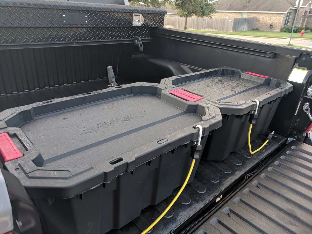

    Harbor freight carries two of these type both work for me. I use them to hold these two Home Depot totes that fit perfectly. Great for groceries etc.

    The only thing i don't like about the bar is, the amount of pressure you are putting to the bed side walls. The OEM divider rest and adjust in the rails without causing any pressure to the bed walls. On my opinion, I would add bed stiffeners in the case of using the bar constantly to prevent any damages down the road.
