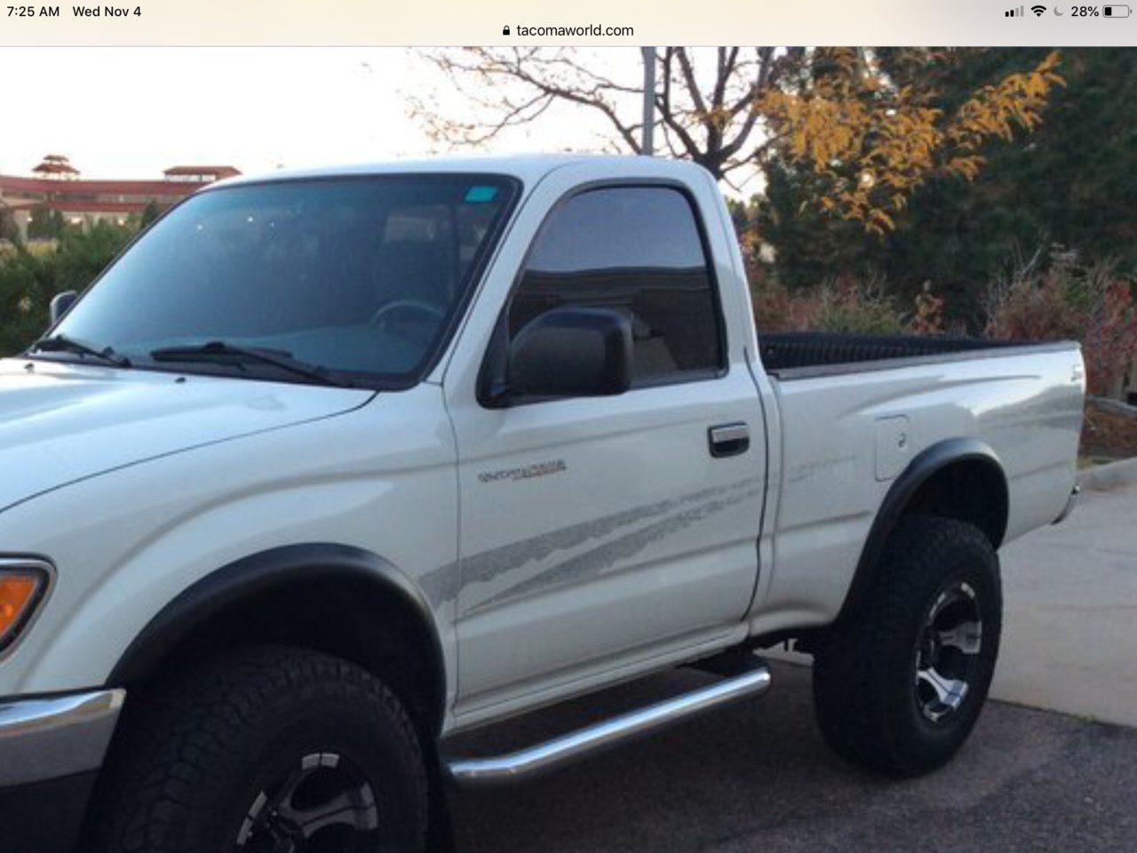

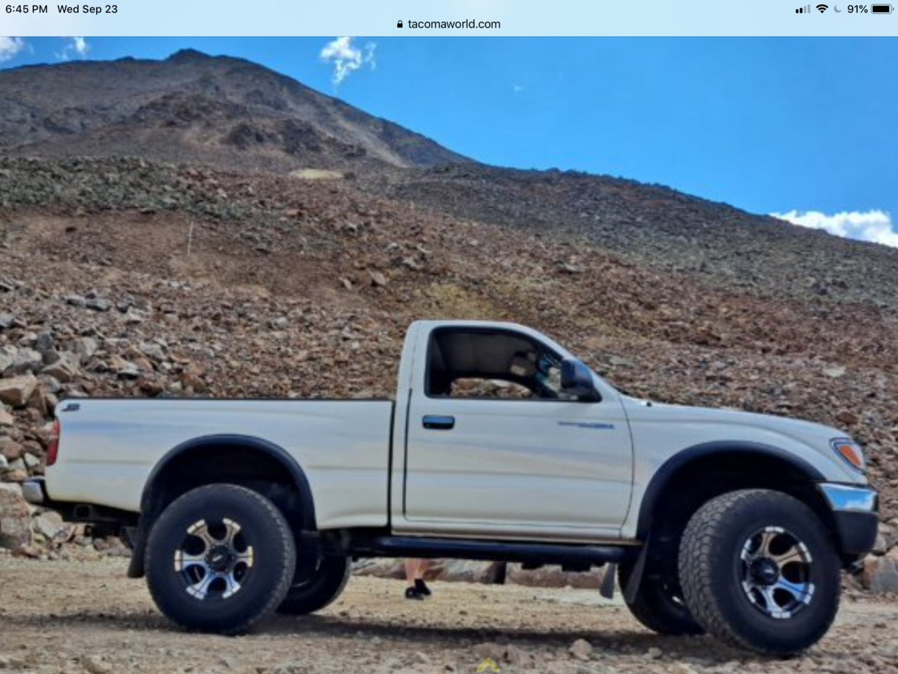

    So your not interested in the OEM fiberglass ones pre 2001?
    The pre 2001 OEM flares bolt from the under side inside the wheel well area and not the body itself like the 2001 forwards

    those look really good

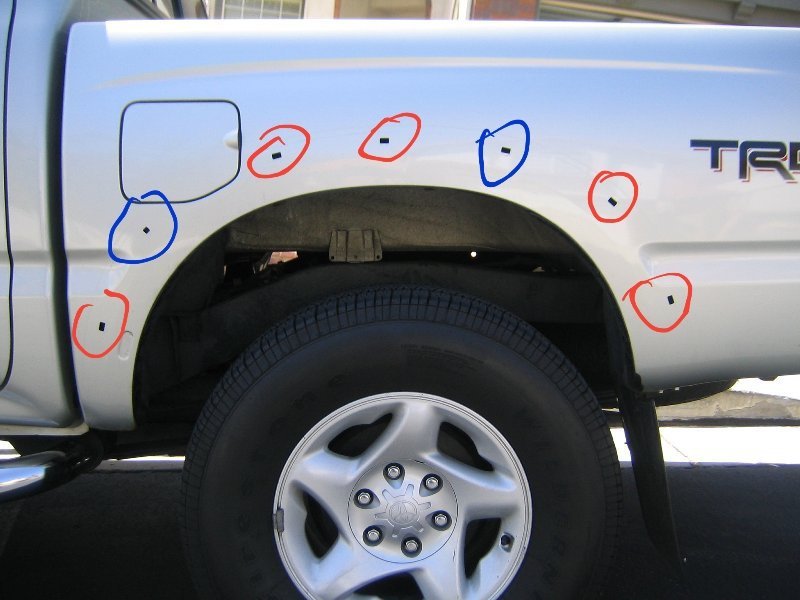

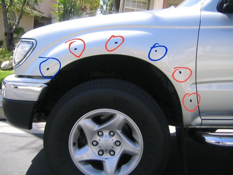

    Make sure to take a pic after pulling the flares off before pulling the old clips. They have a particular installation order.

    Will do I think some holes are square and others circle and the square holes are for the blue clips but ima take a picture just to play it safe

    Better yet.. save these to your phone

    Hmm I actually didn't know they made these. I was under the impression it was only the chrome ones on pre 2001 and thought the black were introduced with the facelift. I'll look into them

    These are the fiberglass flares that were used on the TRD MODELS from 1998-2000,
    They use the same holes as the thin chrome one that you have on now
