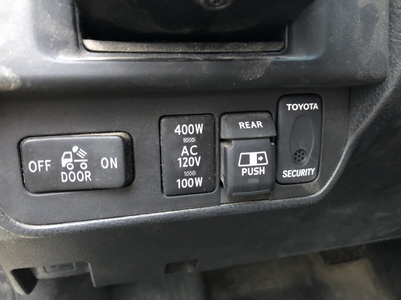

    F4C3F589-4B3A-40FE-9F41-C9CFC4292193.jpg The OEM glass breakage sensor part no. PT398-35160 is plug-and-play and you don’t need Techstream to activate it if you already have the keyless alarm. Also the kit instructions say to not install the V5 harness if your hood latch does not have a dummy plug, but it works with trucks that have a latch release sensor cable installed (I assume having the alarm made that OK as well).
    Edit: As others mentioned below, while installing it don’t worry about detaching your hood release lever cable, it’s possible to work around the panel and leaving it still attached is easier. I also suggest just using the tie wraps wherever you think it will be more secure, following the directions for that did make it harder, and when coiling up the extra cable, don’t bundle it into a tight coil or it’ll be too thick for the side panel to close up again. Other than that, the installation was quite easy.
    As for setting it, start with sensitivity 8 (not 6) and don’t test it right after locking the truck- it has a delay of 30 seconds before it activates.

    Sweet. Installs left of steering wheel, behind where u mounted the break sensor?

    Yup, there was a blank spot just waiting for it! I updated the post above with a photo.

    All of my options are filled over there as the clutch-start-cancel button is in that position instead of a blank. Does anyone know where it'd go in a manual transmission truck?

    Its a small two-conductor lead that goes to that mic, you could extend and attach it anywhere it would be facing the interior of the cab, it doesn’t have to be in the dashboard.

    OP, so disregard this?:

    Yes, as long as you have the keyless alarm. You dont use the little terminal clip with the wire loop on the hood latch either (as long as the hood latch is wired to your alarm and hood open sensor). Also disregard the V5 (cable) statement, the V5 harness included in the kit works.
