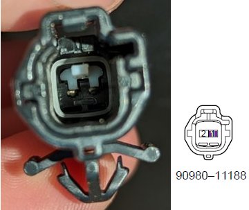

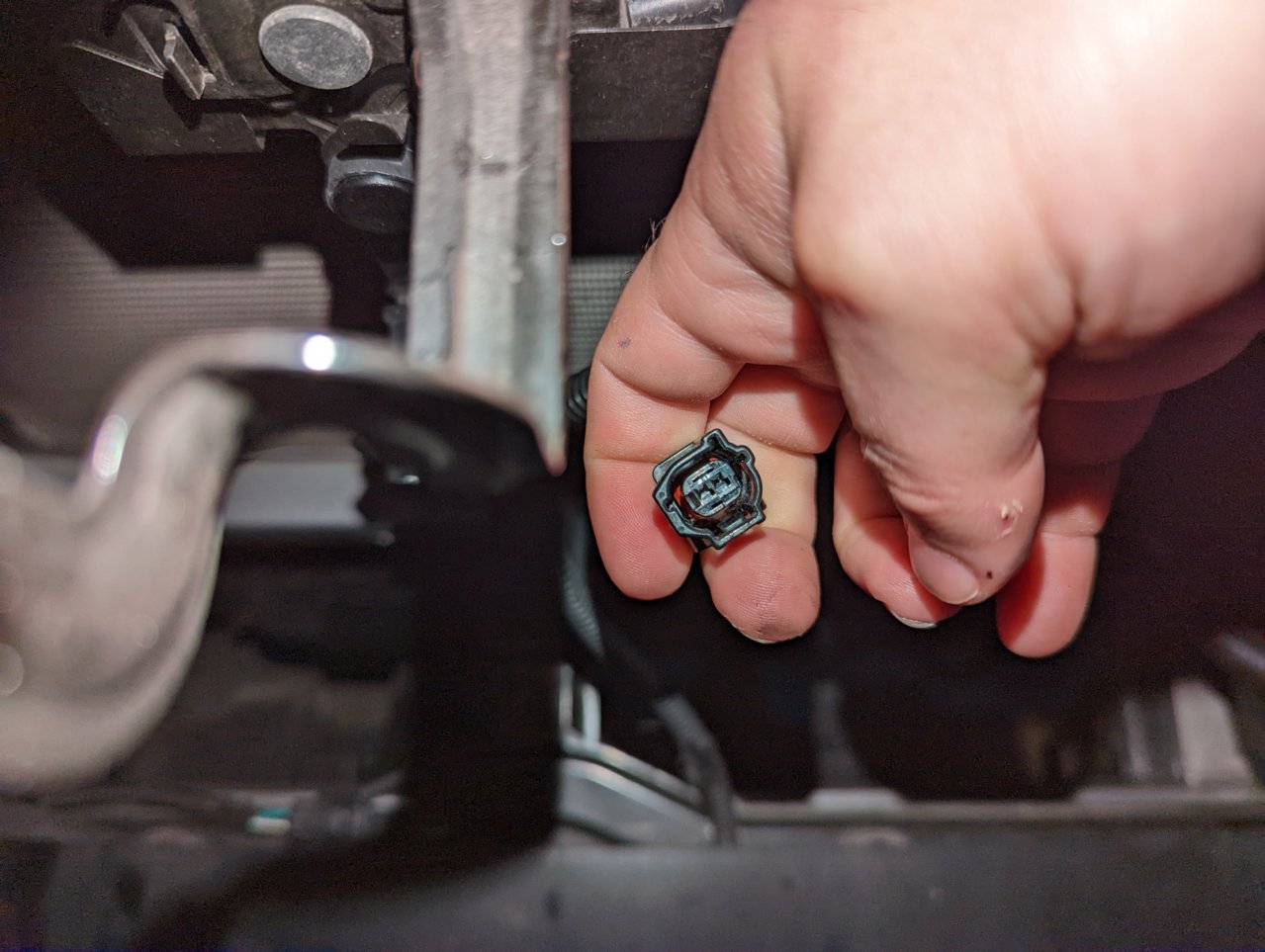

    I don't see why the car can't sound the panic function that it already has when a door is opened. I was hoping to find out if it did but I need to close the loop on the hood latch before it will arm. I'm optimistic that it will

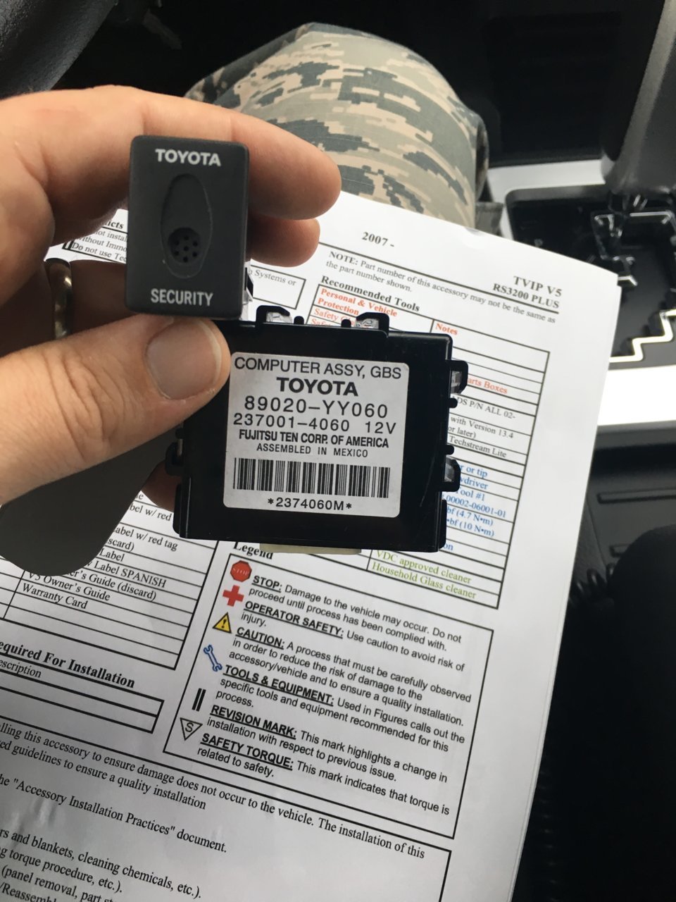

    From my understanding the gbs module functions as the alarm module if you don't have a factory one.

    I think I might have found it. Tundra Gbs Micropho - Toyota (08192-65810). Anybody out there able to confirm?

    interms of the module, you can still activate the security system via techstream minus the module. options do come up to turn on and off even with my module less SR. for shits and giggles i cant use the jumper if you will send me your address i can put it in the mail for you and see if you can jump your switch and use Techstream to activate your alarm function. (if you're inclined enough) otherwise ill just rip the whole thing out and resell on the forum
    i woke up early this morning and placed guitar string wire in an attempt to jump the hood latch and bypass it but no luck on my end. im wondering how to avoid cutting the connector off and joining the wires together since i think thats my last resort.

    Looks very similar to mine. Would need you to take a pic with the connector off. PXL_20220812_104441044.jpg

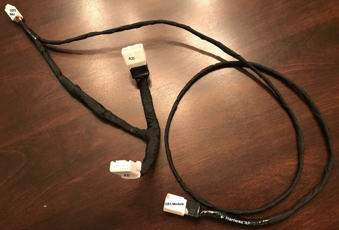

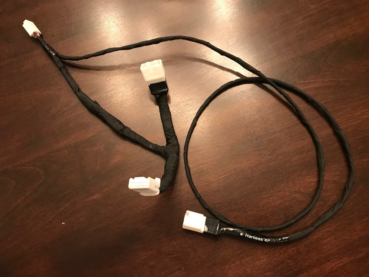

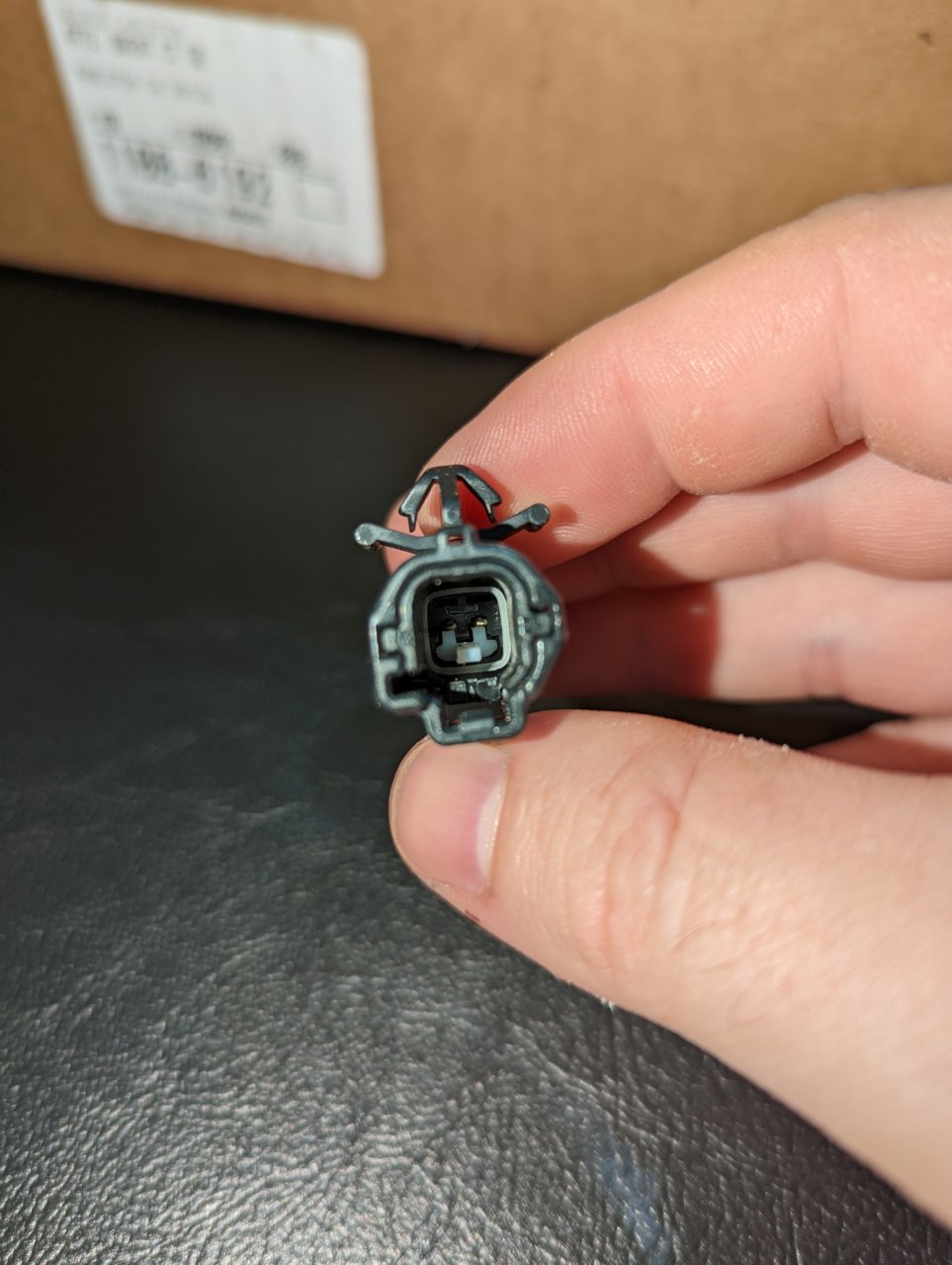

    @caribe makaira I finished the harness. Also, the short sensor showed up, and I verified the polarity on the LED. :thumbsup:

    Like so?:

    @caribe makaira Any chance you know if this is the same short mic sensor, minus the LED? "Tundra Gbs Micropho - Toyota (08192-65810)"

    Because the sensor is from the 2nd Gen.

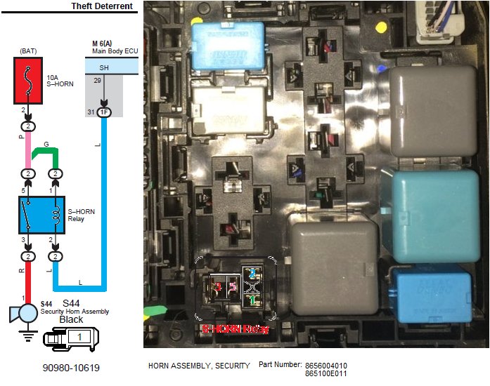

    Vehicle also needs the relay for it...
