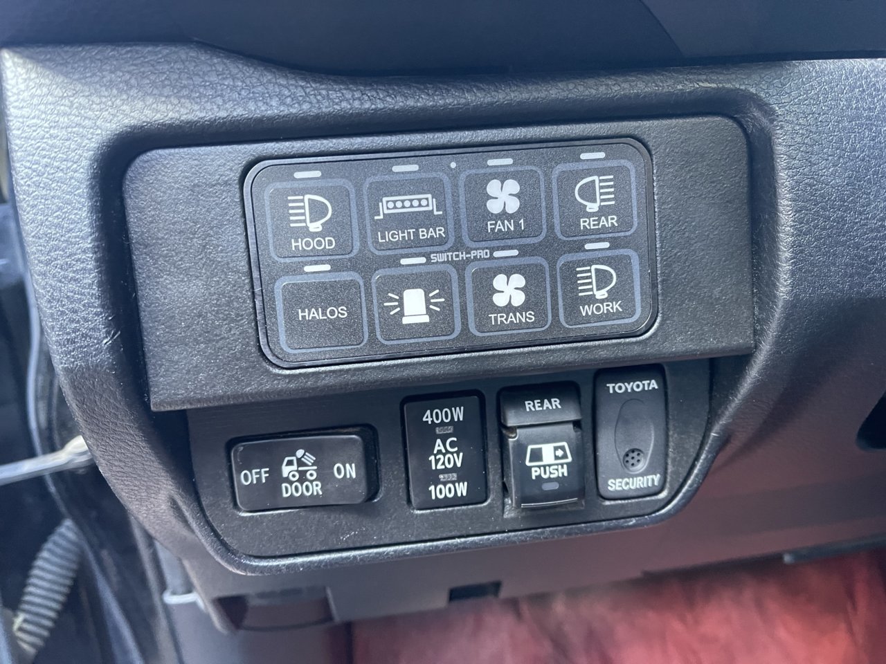

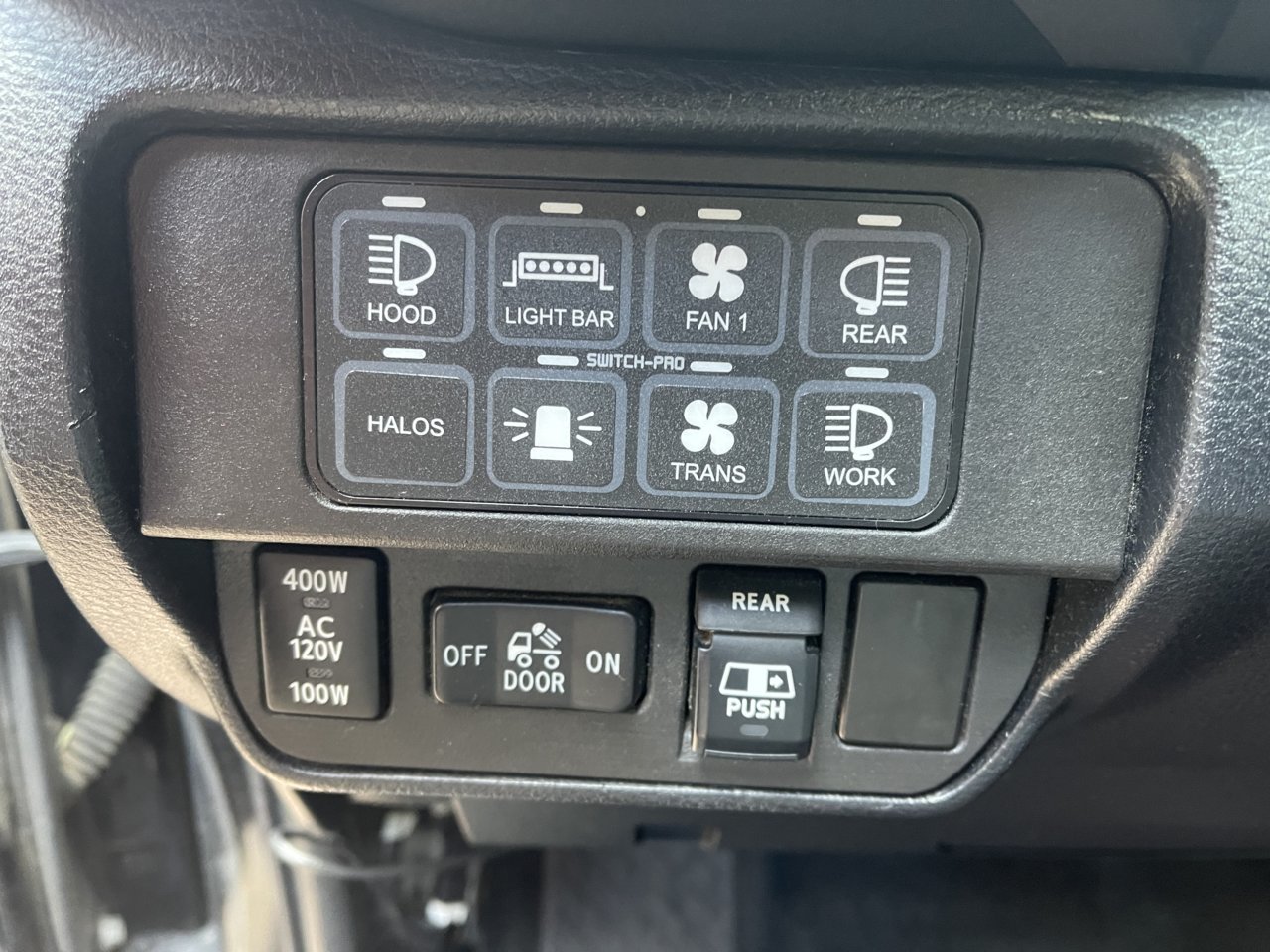

    Well might as well just sell the old one. Here’s a side by side of old vs new. I’m legit frustrated lol
