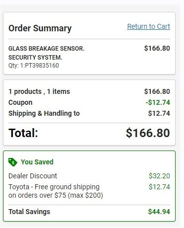

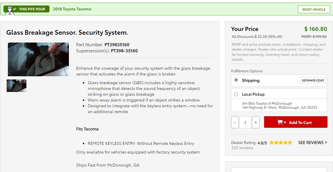

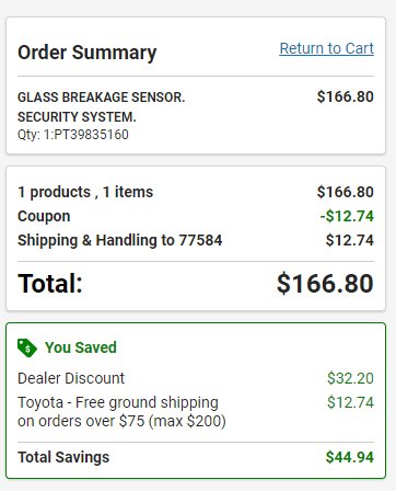

    Looks to be on sale right now if anyone wants to jump on it
    Promo/Coupon code FREESHIP <--- (not sure if it still works)
    VicNic3 likes this.
  8. Mar 23, 2022 at 11:46 AM
    #128
    Xx_Evilvirus_xX
    Xx_Evilvirus_xX Well-Known Member
    Sep 20, 2018
    #266897
    937
    Houston, TX
    2018 Tacoma TRD Offroad 4x4
    Code still works
