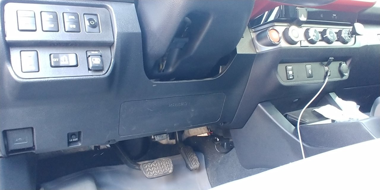

    Here is my lower dash as of now.

    Plan is to carefully mark and route out a rectanglular hole to the right of the camera switch (see photo) with razor blade and/or Dremel wheel. Then cut the second set of flanges on the GBS microphone "switch" so that I can flush mount it with hot glue or similar adhesive.
    Hoping to be able to do this without actually having to remove the panel under the HVAC controls like you need to do to replace the switch panel out with the Meso panel.

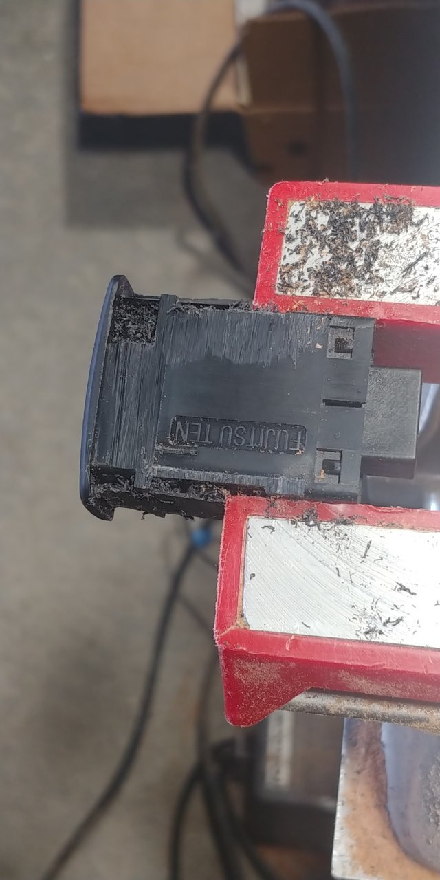

    I did take the microphone "switch" apart. The back of the switch is held on with four clips. I inserted a spudger on each side of the case between the case and the clips and used small pliers to slide the internals of the switch out by grabbing the shoulder of the connector. The inside of the switch contained a small electret microphone about a 1/4 inch in diameter with two wires connected to the back connector. The microphone was secured to the case by a plastic clip. It would be fairly easy to remove the microphone and mount it anywhere on your dash by drilling a small hole and securing the microphone from behind the panel.

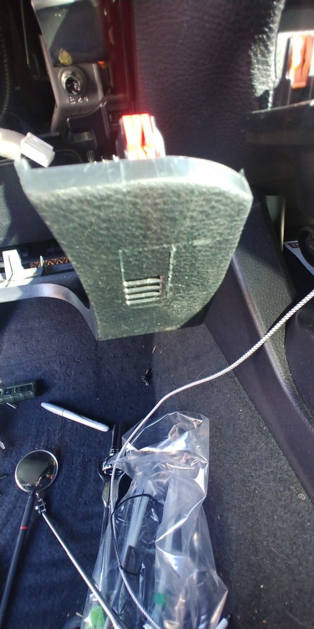

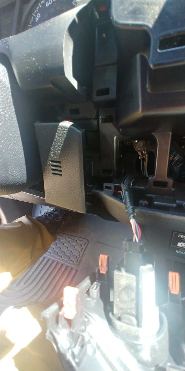

    Did some digging and it looks like there is space to the right of the steering column at the location of the (in my vehicle unused) Automatic Climate Control system sensor. In my vehicle there is nothing behind this. I may be able to mount the microphone "switch" here. Will do more digging and let you all know.

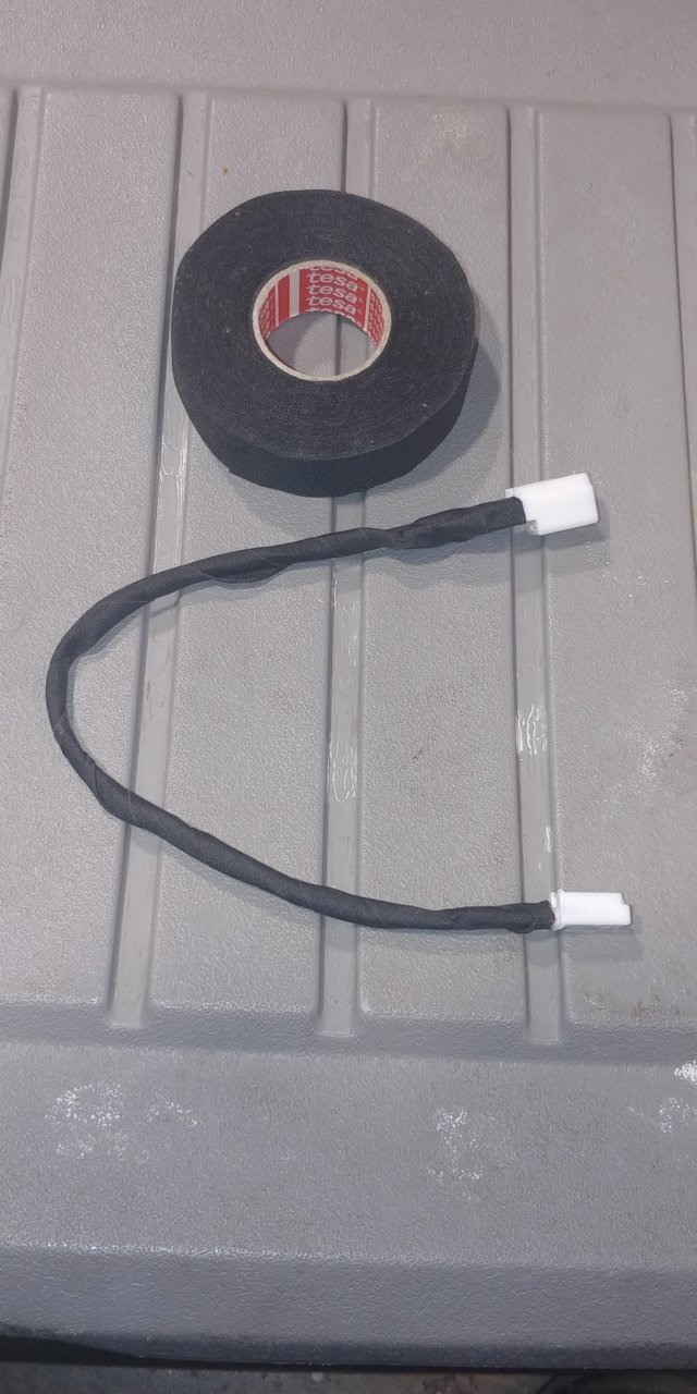

    Cut out the panel and trimmed the microphone unit. Bought the connectors (thanks caribe makaira) and made a jumper out of 18 gauge wire and wrapped with Tesa wiring harness tape.
