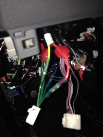

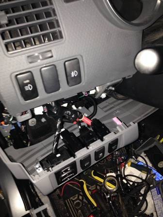

    Got it done, and they work! [​IMG]
    Sorry about the poor quality pics. Hard to tell what they are now.
    Only broke one clip, on the inside mirror cover panel, passenger side. Little bugger must have moved when I tried to reinstall.
    Some tricks I used for my 2013-

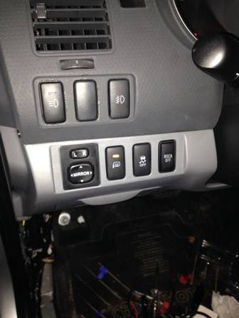

    -Installed the switch for heat right next to the mirror adjustment controls. It ended up being a really tight fit when I put the bottom dash piece back on. I may have pinched the wires for when the lights are on, because it worked and now it doesn't. Will pull it apart tomorrow and have a look.

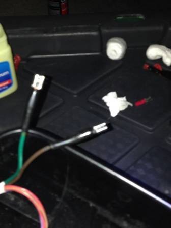

    -used 16G wire for behind the mirrors. Vasoline is a good friend :D. Grounded to the door, and ran the passenger side along the frame bar above the glove box, like others have done. [​IMG]
    -tapped into the mirror control + lead (grey wire) for control power to the relay.
    [​IMG][​IMG]
    -ran a 12G + lead to #30 on the relay from my newly installed Blue Sea 6 circuit board.
    Pretty straight forward install, once I identified where I wanted to get power from, and where I wanted my switches to be. Winter is supposed to come for a while here, so I'm a little more prepared.

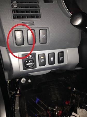

    Benson X: My apologies, but I have to ask a question unrelated to this thread:
    Schwangster: details on the switch circled please:

    Not to answer for him but that's a driving light switch from an FJ Cruiser.

    Yes, that is an FJ switch, for the 30" RI bar in the grill.
    During the mirror switch installation I swapped positions of the fog light switch and this one (used to be in the upper middle hole). I don't use the fog lights very often, and leave them on when I do.
    The light bar I use frequently with the high beams when I'm travelling. I like to manually shut down the LEDs, then the high beams as the oncoming gets closer, then go to low beam. With the switch in the outer position it is an easy reach to click it off.
    The middle hole needs to be filled :rolleyes: and I have a set of D2 spots (off my old XJ) and I want to add some back lights. So we shall see what goes in there. Not decided yet.
