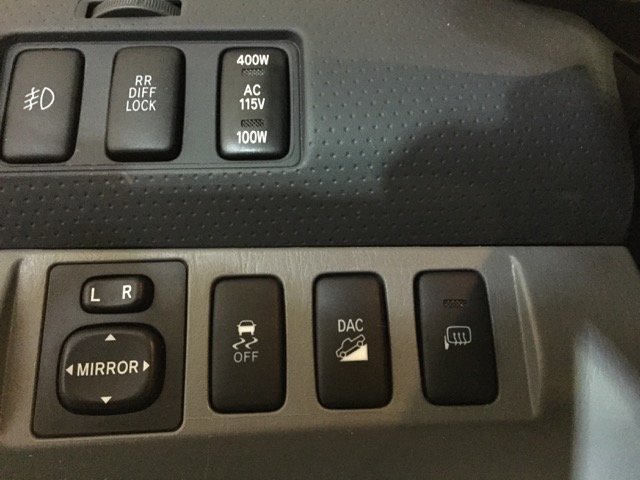

    I have also completed th is mod, but here's what I did... I bought a traction control switch from a camry and extended the wires to under the radio so now it fits next to 5 be a Trac switch. The harness I made had long male spade ends and I plugged it into the original p look ugh for the traction control switch... for the heated mirror switch illumination illuminated spliced into the wiring from the Trac switch. If I ever decide to undo this it would be simple as no wires were cut.

    I had originally assumed since I had used the switch blanks under the HVAC in my truck for lighting switches I wouldn't be able to do this mod, but by moving the RCSA switch and placing the one in there, you might be onto something.
    You said you stowed your switch behind the panel, can you easily access it without having to remove the dash? I just ask because if there ever were a situation in which I had to disable the side airbags, how difficult is it to access, or is it really stuffed back there?

    I chose to tuck it up above the fuse panel out of the way wrapped in some bubble wrap to prevent any rattling. So, not accessible. I'm sure that you can store it further down to the right of the fuse panel and then you just need to pop out the storage bin to get to the switch.
