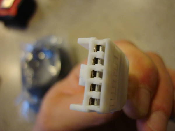

    I designed my own relay board to attach directly to the Connector and eliminate having a big external relay that you have to find a place to mount. The relay is automotive rated for 20A. Plan to find a piece of large heat shrink to cover everything up so there is no exposed 12V.
