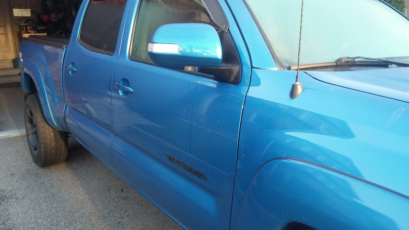

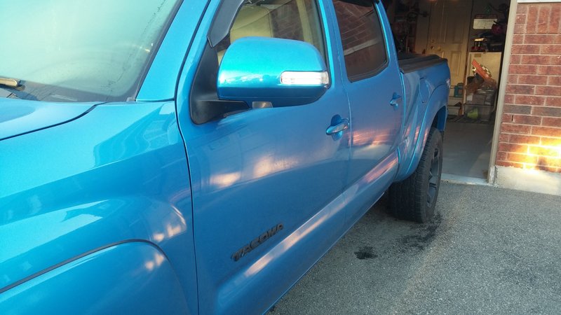

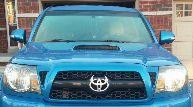

    I went with the 4runner mod. Had the whole housing colour matched. Way better than half and half.CAM00119-1.jpg CAM00121.jpg CAM00120.jpg

    The puddle lights are a nice touch on those. Are you going to try and get the folding mirrors to work? I don't think anyone on here has done that yet.

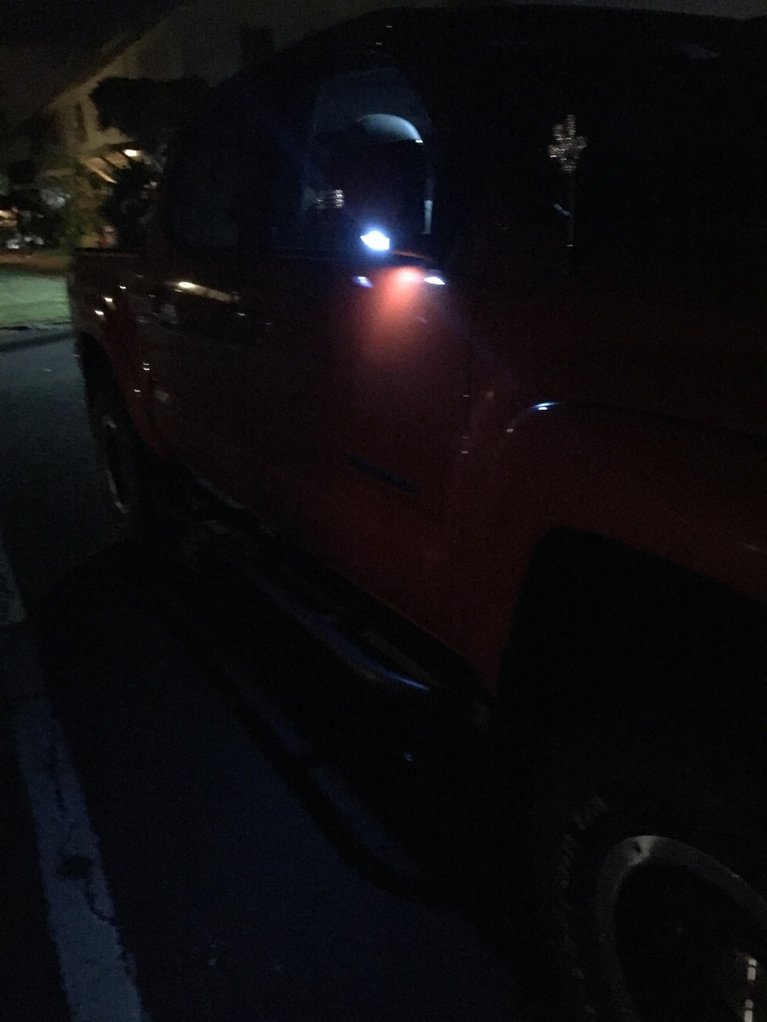

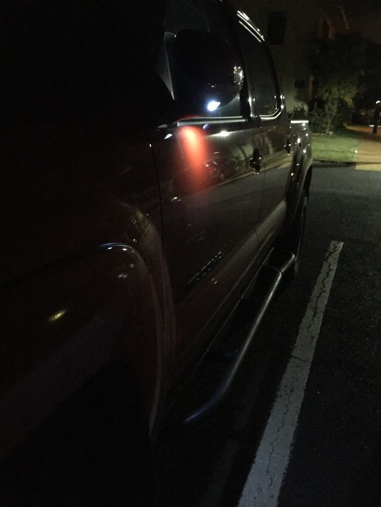

    Nice. Suggest replacement the bulbs with LED bulbs. Puts out more lights.
    Pics doesn't do it justice, but you get the idea.

    uptonogood No I don't have power fold in these mirrors.

    You weren't kidding that the pics don't do it justice... still looks dark on the ground lol..... but yeah using LED would be a big improvement.

    Haha thanks. I actually got the mirrors folded in.
    As for the power folding feature I've tried searching for viable options. Closest mirrors would be the Sienna Limited. It ain't cheap though, if I had the $$$ I would haha. Plus I don't even know if it would bolt right in with the Tacoma bracket. That and you have the wiring to worry about. It something that I am going to look into.

    Are those Turn Signals in the Mirrors or are they some sort of Lights? BTW they look good!

    4Runner side mirrors, led turn signal, spot/puddle lamp and heated mirrors.
