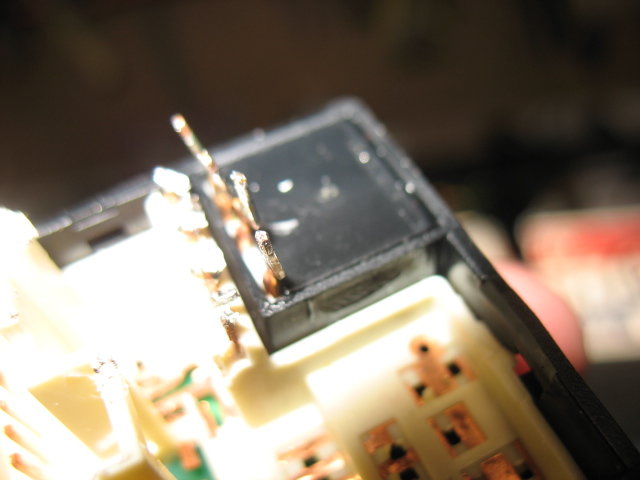

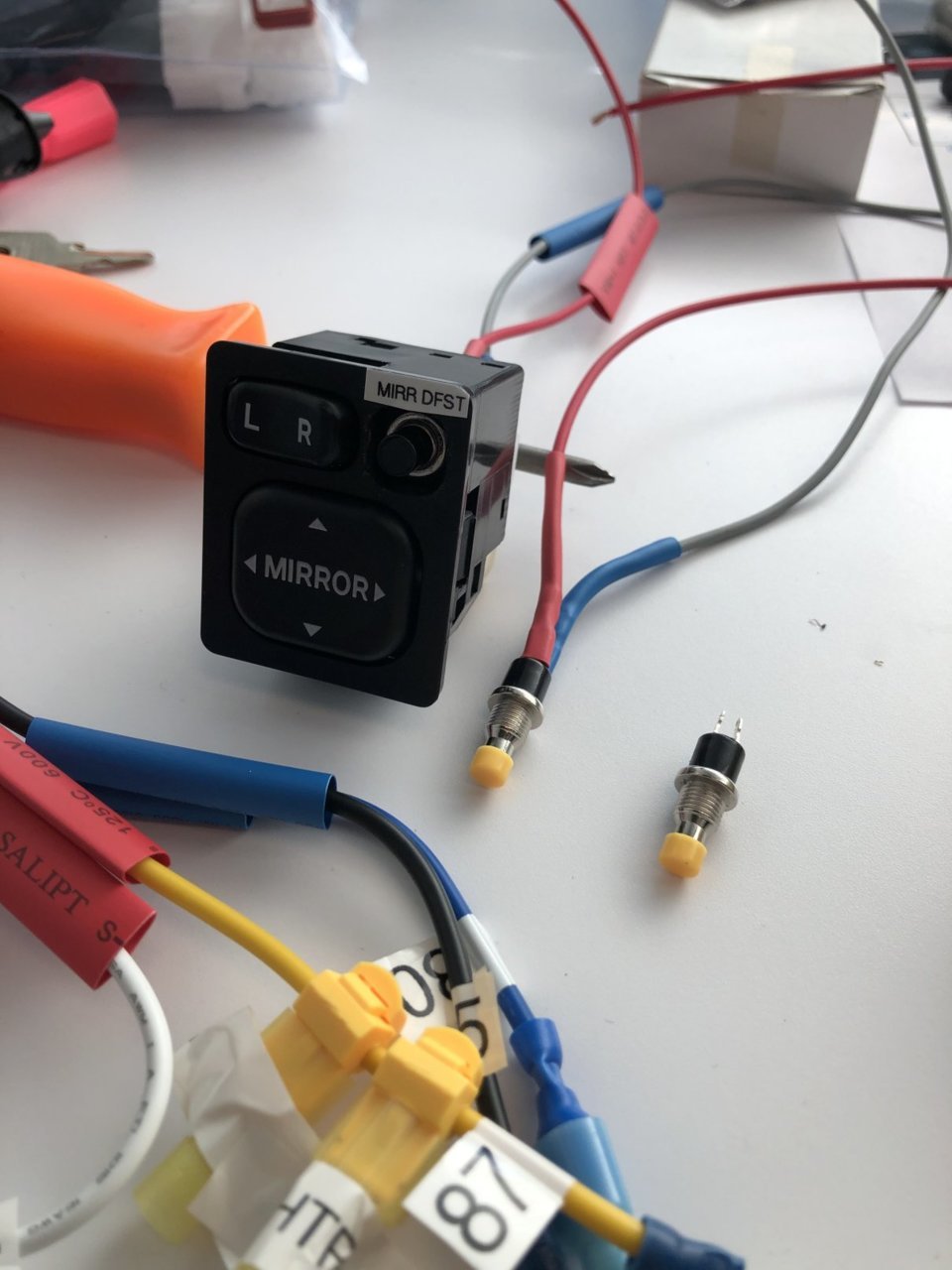

    Using a Toyota OEM/like switch I got on eBay for $20, here is what I ended up with for a momentary on switch to trigger the timer for the heated mirror circuit:
    As you can see, the micro switch replaced the OEM on/off switch that closes the mirrors. I simply de-soldered the terminals on the OEM mirror close button at the rear, removed it, drilled out the square hole with a 1/4" drill bit and made it round. A little sanding with a round metal file made the micro push-button switch slide right in.
    The two yellow switches are spares to show what they look like outside of the switch box. I got the micro switches on Amazon. $8 for 10. Normally open, push for momentary close (on). This triggers the timing circuit on.

    When I plugged my $20 eBay switch into the unaltered OEM harness plug the mirrors worked perfectly. Which was all I really wanted. I needed to solve the momentary switch issue so this was my simple solution.
    to answer your question, all of these switches *appear* to be identical to the OEM switch. Which is why I took a chance on the eBay one.

    I am not sure but I think you misunderstood. These OEM mirror control switches do not have any timing function. Their original value to the heated mirror thread was to provide a space for a momentary switch inside the mirror control dash cut out. The process cannibalizes the mirror fold switch. Which, as delivered, acts as a hard on/off switch. The first mod is to remove the metal bar inside this push button to convert it to momentary on only. THEN you have to figure out a way to convert the four wire terminals on the output to act as a switch, which is mod #2. (See below for detailed explanation of MOD #2***) I did figure out how to do mod#2, but I destroyed the push button circuit board in the process. So I decided to get rid of it entirely and use the micro push button switch. I have a 2015 DCSB OR. I have zero dash spaces open for a switch. So I am using this mod to avoid having to cut a hole in the dash on the left side of the steering wheel.
    The timing circuit you need is a hella relay with adjustable time circuit.

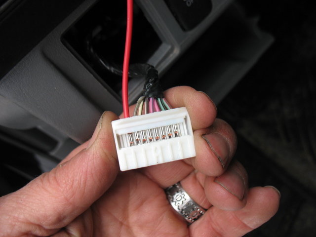

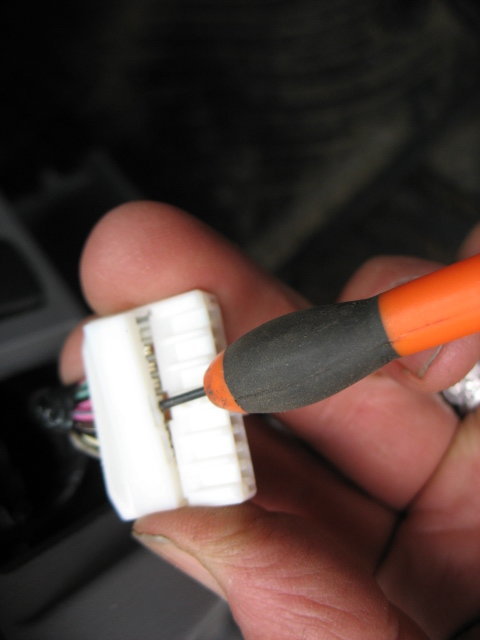

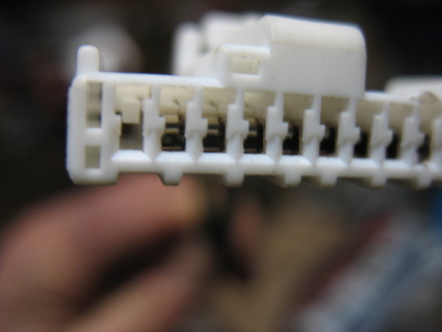

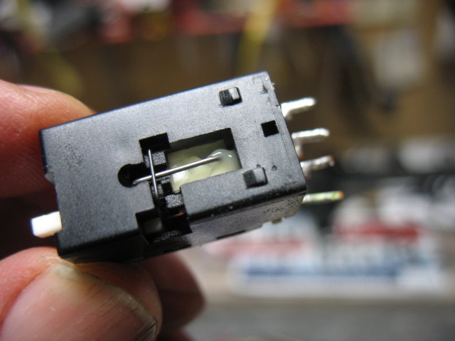

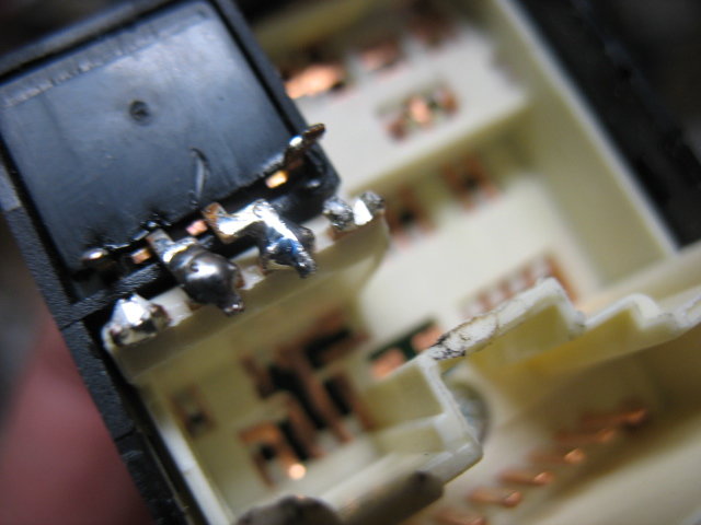

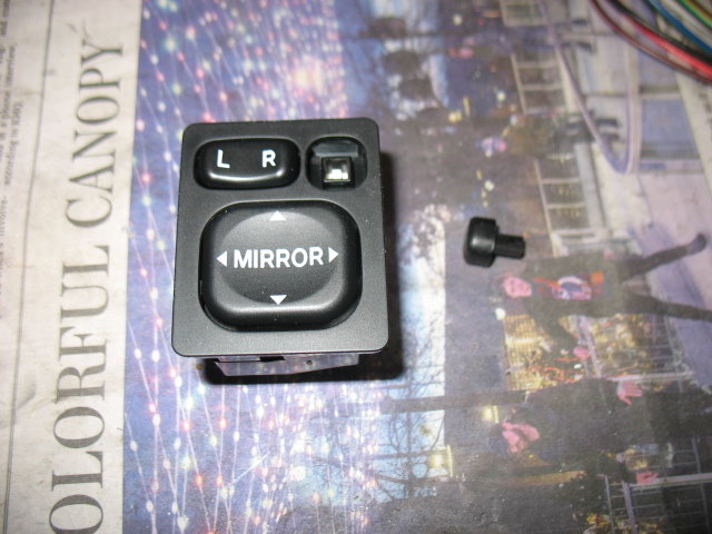

    Follow-up on modding the $15 eBay folding mirror switch. (Get the one with the connector included.) This is to give you a +12V momentary push button to trigger your circuits timer relay. This is on a '13 TRD Taco
    Pull the folding mirror push button off the front of the switch, it's just a friction fit, but you may have to pull the outer bezel away from the switch body to get a hold of it.
    Pop the rear white cover off and you will see the four soldered connectors on the back of the folding portion of the switch. Unsolder all those to free the switch, then you can gently pry the housing away from the tabs on the switch and pull it out of the main switch body. On the side of the switch you will see the silver latching link under a little spring, remove it and then place the switch back in its recess. Push the button back on from the front.
    The "folding" portion of the switch already is connected to +12V from the existing mirror wiring. if you only solder back the two center pins, you will see momentary +12VDC at pin 9 when you push the button, which you can use to trigger the delay relay. Leave the outer pins disconnected.
    Snap the white back cover back on and your switch is good to go. Now we need to pop out the old mirror switch and add another wire to the truck's connector. On the underside of the connector that came with the switch you will see a little rectangular cover/wire retainer that you can pop out with a little screwdriver. There is also a tiny little locking finger inside the front of the connector that you will need to lift in order to slide a wire out the back of the connector that came with the switch.
    Take the new wire and slide it into the trucks connector from the rear, replace the wire retainer cover, pop the connector in the switch and the switch in the dash and you should be ready to wire the power part of the circuit!
