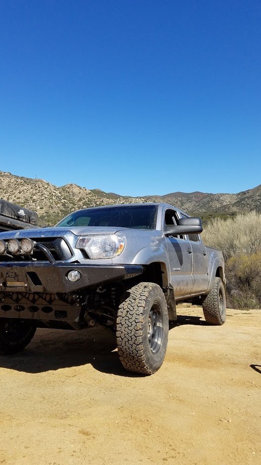

    Why are folks not doing this instead
    saw these in person on a Tacoma the other day. Folded in they looked good and not noticeable.
    not only is it heated
    Significantly cheaper
    maybe easy to DIY
    but they also extend to tow. And might offer a side signal.
    current mirror caps are chipped to hell would take care of that too.
    TegoTaco and bagleboy like this.

    Eh, I'm not a fan of the tow look on a Tacoma, personally. I'm digging the 4runner/Tacoma mod. I got my set up with sequential blinkers, a puddle light, and a heated mirror (I still need to finish wiring this part). I used some Deutsch connects for an almost OEM-like fit. To make this mod easier, the Vled floor kits have modules that make wiring the puddle lights a breeze and the blinkers you tap under the driver's side. Just takes time but not the hardest mod and was fun to do. I cant recall if i posted a photo but can dig one up.

    There are tons of folks running the ProEFX tow mirrors. They're a great option if you want towing mirrors with all the bells and whistles, but they still require wiring for the heated options.
    https://www.tacomaworld.com/threads/proefx-towing-mirrors.244365/
    If you do a search for 'ProEFX' you'll get quite a few threads and reviews. I wasn't able to find a specific how-to or install thread, but they should be plug-n-play and come with installation instructions.
    If you need help with wiring a heated mirror switch - just follow the steps and relay diagram outlined in this thread.
    They protrude too far for my use and would definitely get damaged on some of the tighter trails I've been on, even if folded in.

    thanks for the confirmation yeah that was a concern
    Stock is nice, tucked in, looks good
    while the black wide ones exactly, sticks out looks like it would hit
    Benson X[QUOTED][OP] likes this.

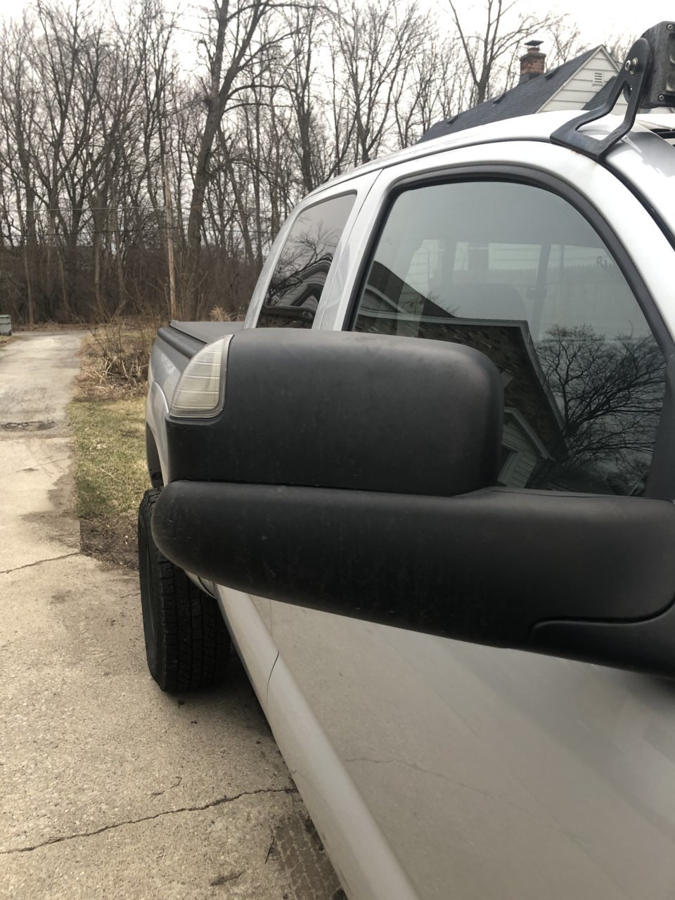

    I was in San Diego for the last couple of days. There was some major storms here in Ohio, lots of hail. The smaller adjustable mirror on my passenger side was struck and shattered. I reached out to Spotter Mirrors just to ask if they sold only that smaller piece, and they advised they did not, but they did offer me a 25% off coupon to replace my mirror. They didn't have to do that. I'm outside any manner of warranty period and it was definitely an act of god which would be exempt.
    So I guess I'm a customer of theirs from now on.
    Just as an aside. My suicide doors are equipped with rigid MOLLE panels over the smaller windows, which makes shoulder checking less than ideal, the smaller convex mirrors on the Spotters have become invaluable to ensure I'm not missing something in my blind spot.
