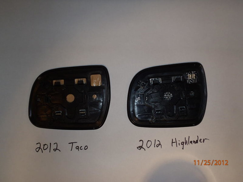

    I got all the items (switch & terminals, etc.) coming in for the OEM heated mirrors.
    My wife has a '12 Highlander and traced her mirrors to see if they match my '12 Taco... the glass outline matches perfectly unlike some claims of the Sienna glass.

    I just removed my wife's mirror from her '12 Highlander and the mirror from my '12 Taco.... They both fit one another!
    That being said, the '12+ Taco owners can save a step from having to remove the backing plate/foam adhesive, the are the very same plates (holding clips and outlines).
