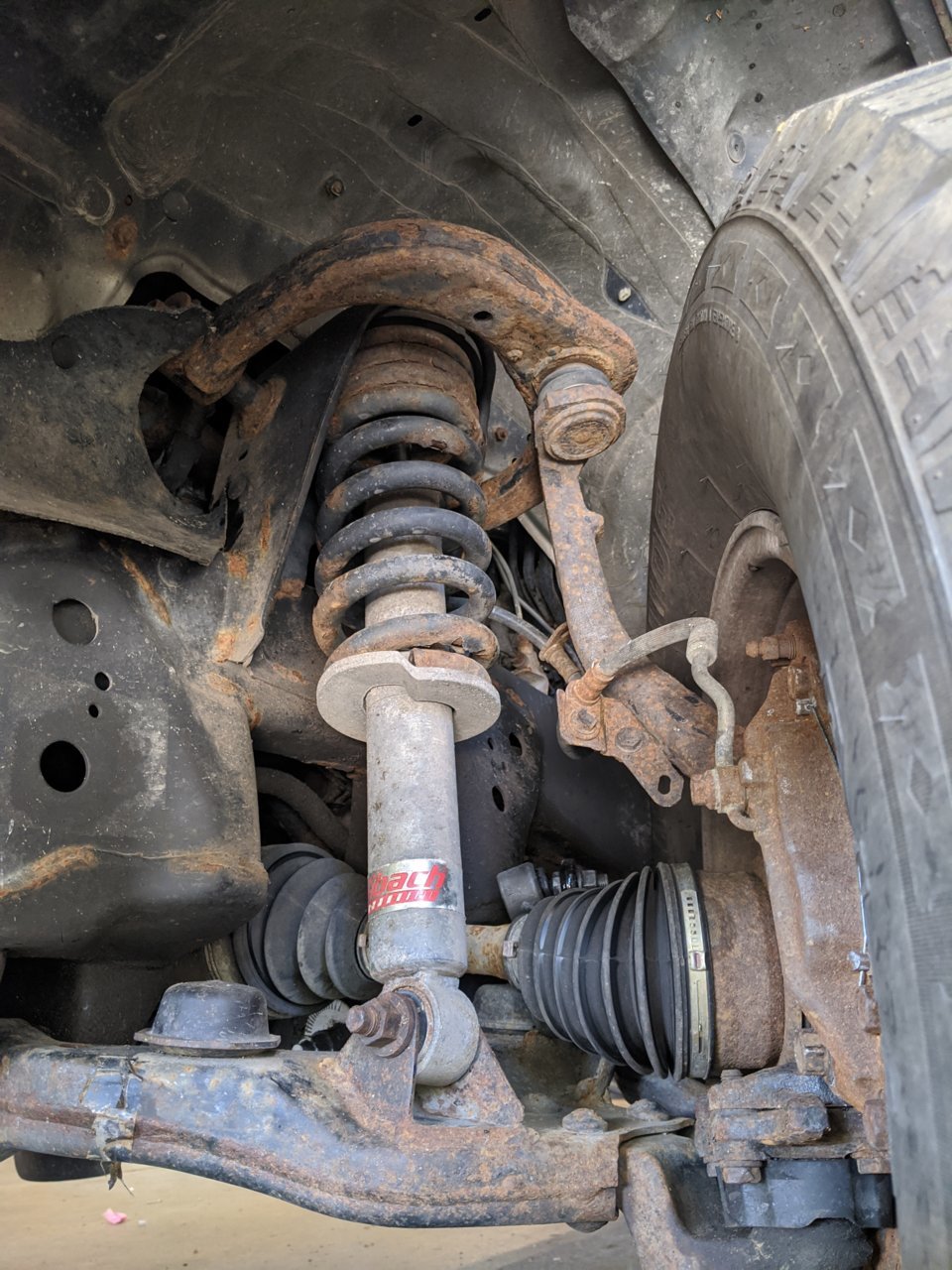

    Ordered some OEM lower ball joints. Now I'm wondering if I should replace the upper control arms and ball joints while I'm at it. The upper arms seem pretty rusty and it doesn't seem worth it to clean them up and press new bushings into them so I'm leaning towards new. I like the trucks height but wouldn't be opposed to lifting an inch or two down the road and would like the flexibility if it isn't too much more then OEM. What reasonably priced options are there for upper control arms and ball joints? I'm not sure if it is stock height. The shocks were replaced when the frame was done. Is there a way to measure stock height? It's a TRD SR5 DC.

    I'd replace anything rusty especially in the front suspension. Do all the ball joints or really really bad stuff happens.
    While it's in the air check the wheel bearings for play. Also check the common rust areas, the front leaf spring hangar especially. If possible try and stop some of that rust.

    Trying to bring this back to upper control arms. Options:
    OEM 48066-35120 (Right $351.73) and 48067-35050 (left $351.73) $703.46 total - seems to be complete with upper ball joints, control arm, bushings, and hardware. just the control arms are about $200ea, ball joint assys are about ~60, bushings ~25, hardware ~70.
    JBA JBA-10.00.HC.EZ - $459.95 for the set. Seems to be complete except hardware (long bolt) 2 arms with ball joints, JBA EZ Lube bushing kit, 2 ball joint adapters. - Will these work without a lift? ie on a normal height TRD? Seems like a cheaper option then OEM and its red too which must mean its better.
    MOGG $115 per side for just the control arm and bushing - I would likely use OEM ball joints with these.
    Clean up and paint originals. $20 in shop supplies, $15 POR15. New bushings $50 (both sides), Joint assys ($120). So about $200 plus some PITA.
    I know there are a bunch of other options and I know you smart cookies have already done this every way possible. Any thoughts on above? $700 to OEM something that isn't broken seems a bit excessive. I'm leaning towards ether MOGG with an OEM ball joint assy or JBA if it works at stock heights and has a stock feel.

    I think it really depends on your end goal. If you don’t plan on doing a lift or bigger tires sticking with OEM or an OEM like replacement is fine. If you do plan on lifting or running bigger tires then considering an aftermarket UCA becomes much more digestible since it gives you more range of adjustment for that lift or bigger tires.
    I also think you probably have more room for an aftermarket OEM style replacement on the upper ball joint than the lower. I know the lower ball joint is critical and documented many times over here on TW, but I don’t remember stumbling across a whole lot of upper ball joint issues. Anyone who knows more on the upper ball joint please feel free to chime in, perhaps it isn’t as documented because so many choose to upgrade the upper control arm and thus the ball joint (delta joint, etc).
