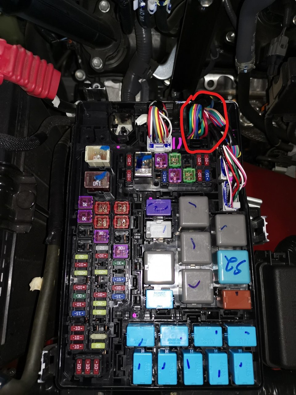

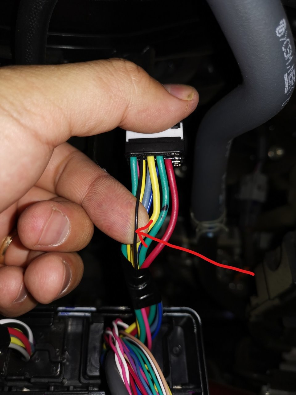

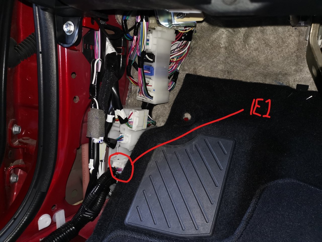

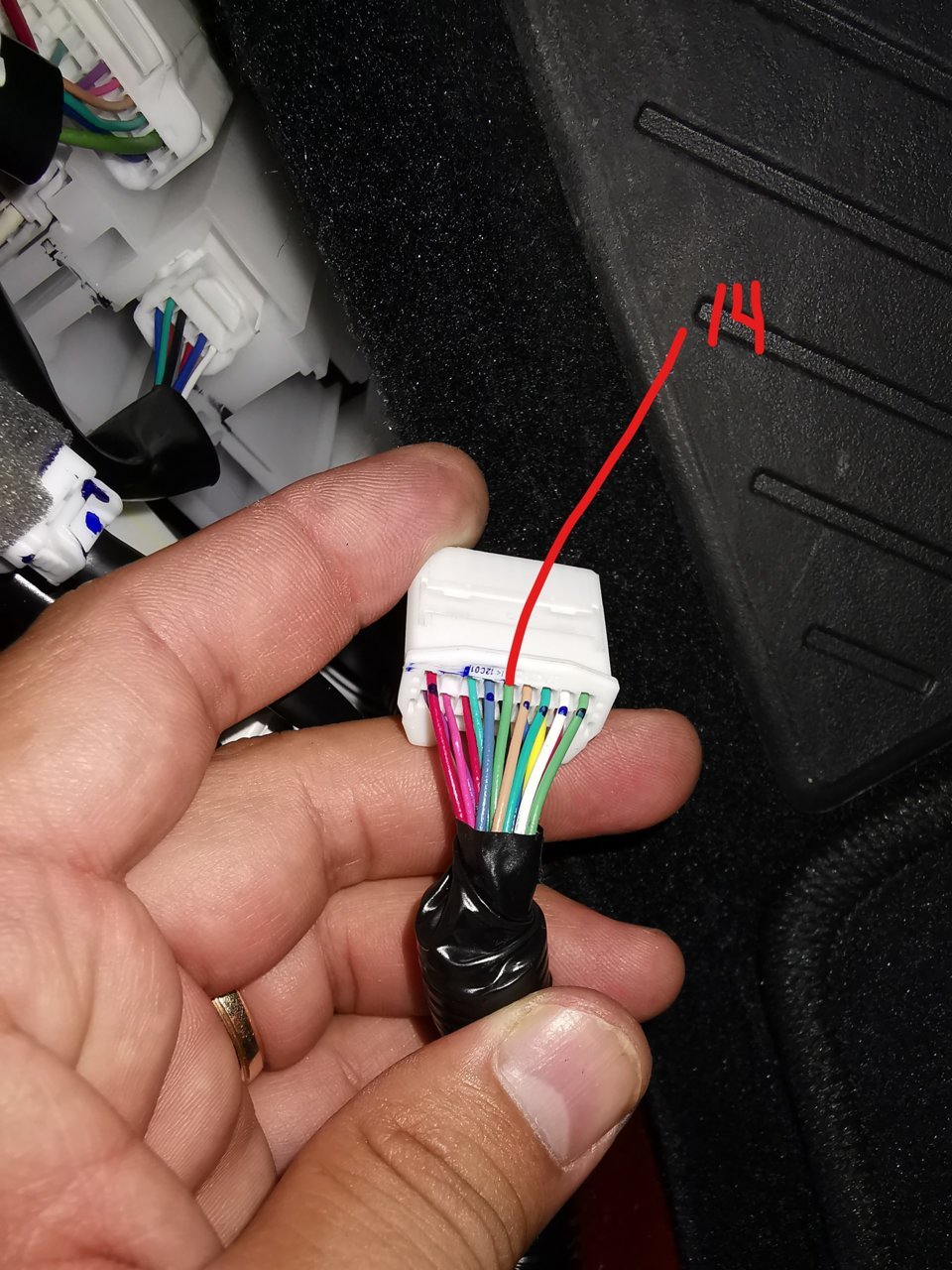

    Well, for the issue some pre wired 2020 Sport have, after root causing it as I explained in my last post, fix was easy enough!
    First, connected bed light wire to a new jump wire in the main relay box:
    Routed the jump wire out of the relay box, and into the main cab, near the driver sidekick and tapped it into IE01 wire #14 [light green - Cargo light hot wire per the diagram @caribe makaira shared before]
    And thats it! Bed lights fully working and controlled by the cargo lamp switch as expected.
    Hope this post helps those with issues. Thanks!!

    Hood Struts, My version Fogs always ON, Map & Overhead Light Mod,

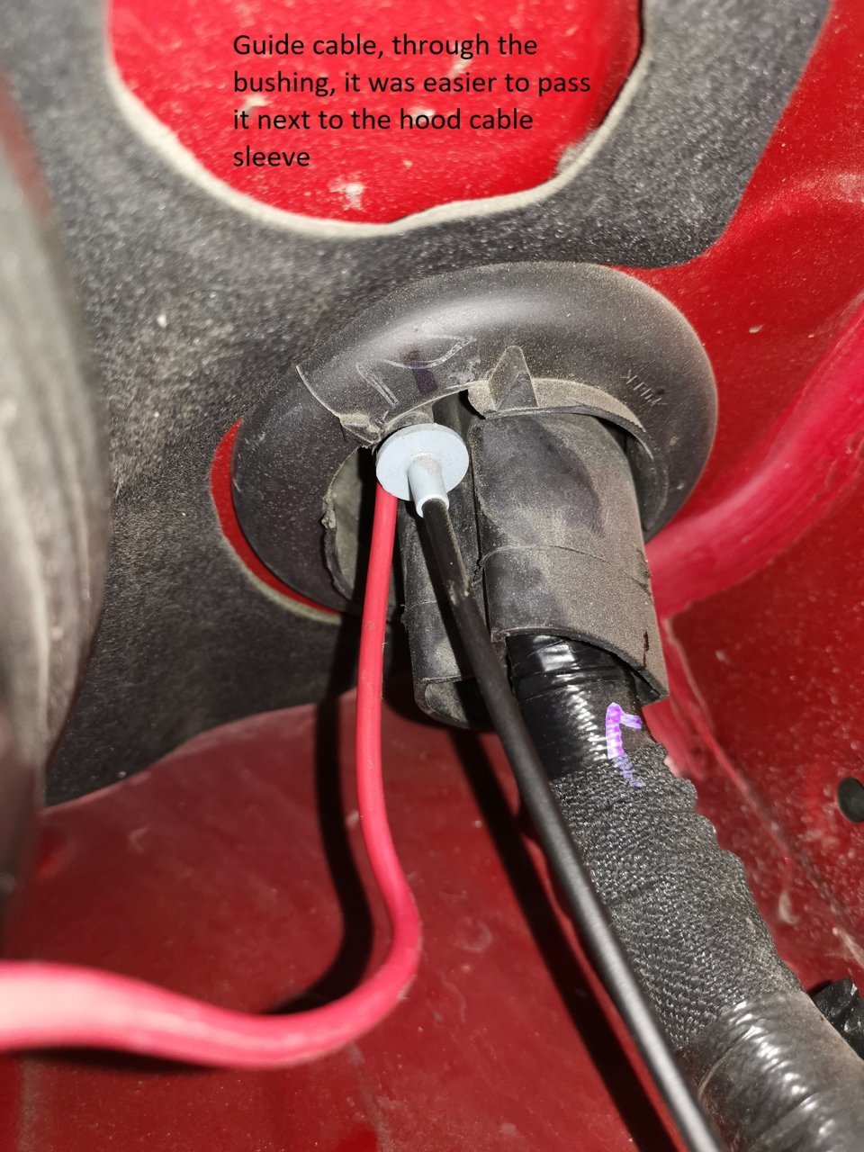

    What did you do to run the wire into the cab? Did you find n cut the nipple on the harness grommet?

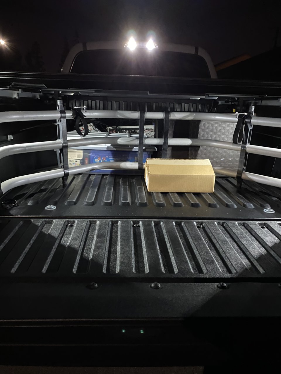

    TacoTacoTyler
    TacoTacoTyler Member
    May 11, 2020
    #327701
    17
    Tyler
    SW WA
    2025 4Runner TRD OR 4x4
    2020 Tacoma DCLB 4x4 SR5 Midnight Black 2011 Tacoma DCSB SR5 PreRunner Timberland Mica 2.7l (sold)

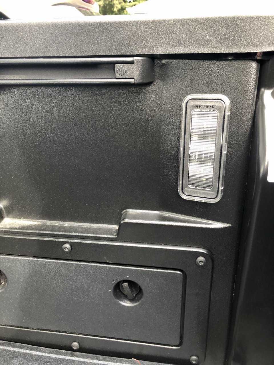

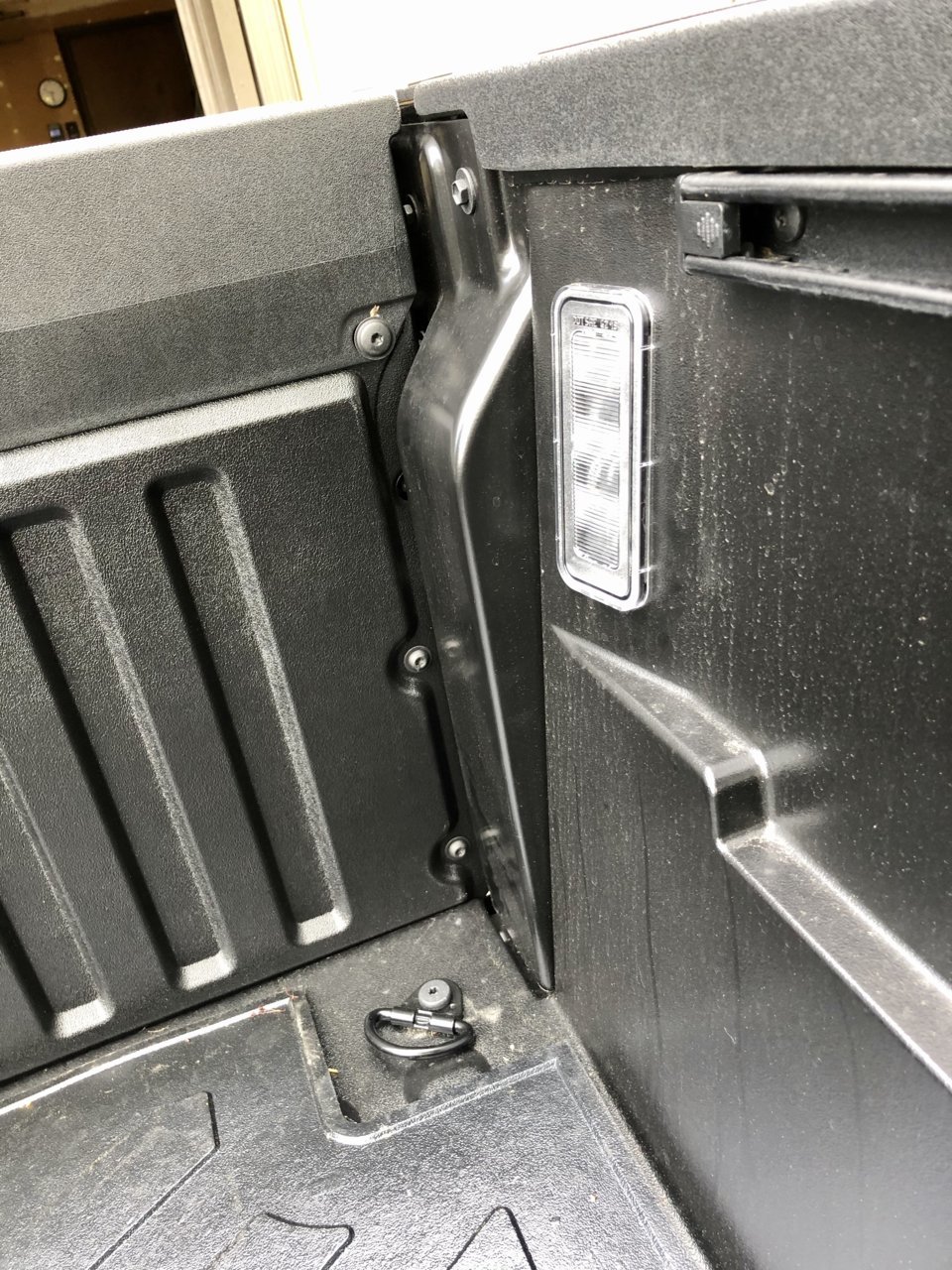

    Love the bed lights in my truck. Very easy to install (20 mins) and completely plug and play in my 2020 SR5 DCLB.

    Parras
    Parras Member
    Feb 11, 2020
    #318942
    13
    Gabriel
    Monterrey
    Tacoma 2020 4x4
    KO2

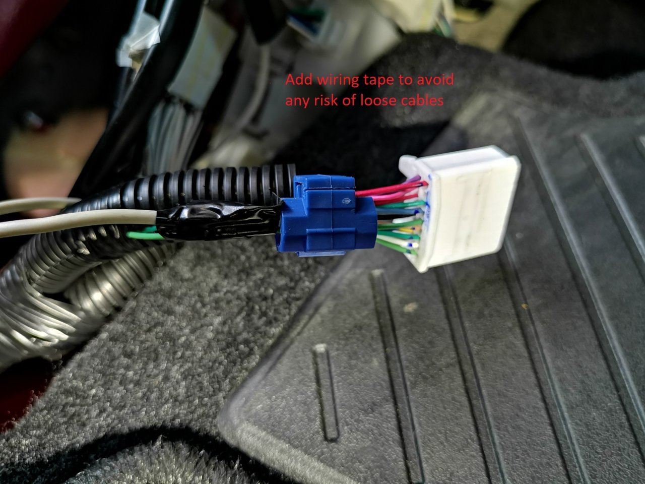

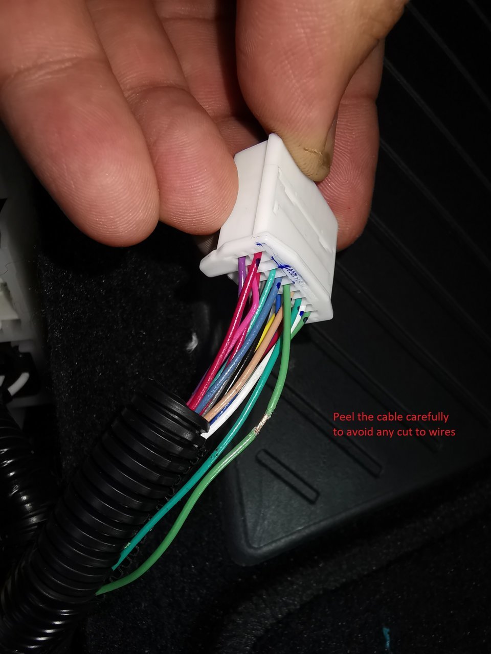

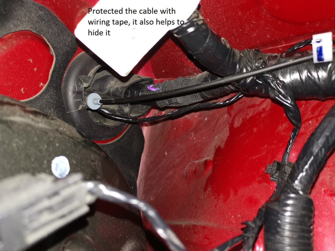

    Ok, I just made the fix for the missing wiring on the Sport 2020, Thanks @caribe makaira and @TacoInCostaRica for the guidance
    I didn’t want to make this because two facts, one, I am paying for a brand-new vehicle that is supposed to perform as expected and the second is that I didn’t want to do any modification that may lead to void the warranty even if this is a simple fix.
    Since I have the light kit installed, I was waiting for the first service in the dealership so they take a look into the issue and fix it, but I see it coming… The service guy questioning who told me the kit was compatible, who installed the kit, you know these guys
    Anyway, I was bored and decided to do the fix causing the less modification to the vehicle and hiding it from a service technician general inspection to the vehicle
    This is a very simple fix, I used splices terminals for the missing jump wire, these are a pain to install since the cable gauge is too small
    Here some pictures of the process
