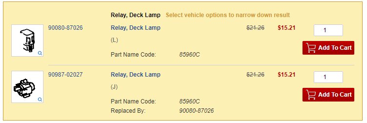

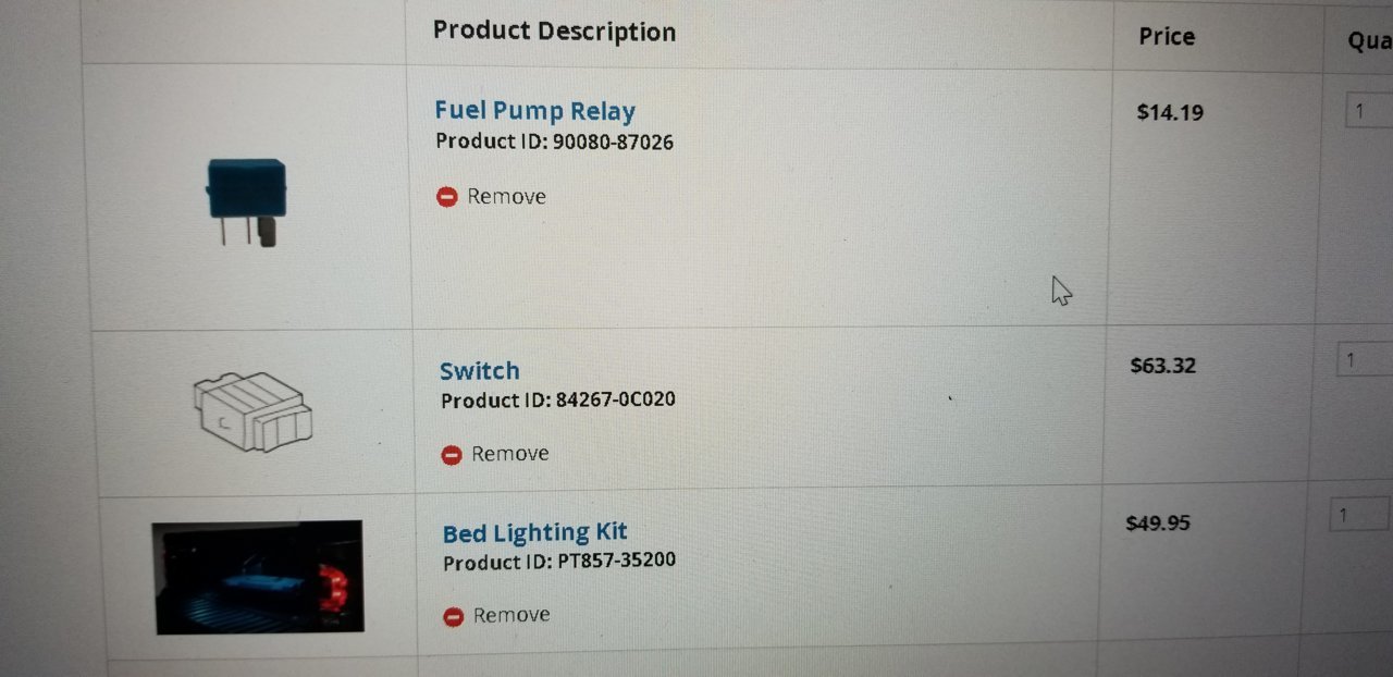

    Is the relay part # correct? Fuel pump relay?

    Thanks for the info and great info! Did this on my SR today without a hitch. I bought the relay but didn't need it as it was already installed. If you need the relay, hit me up!
