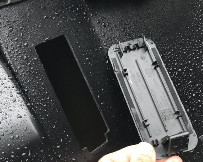

    Can someone please take measurement of the actual hole in the bedside for me? I am trying to retrofit the new style oem led bed lights into my 2019 truck. I need the measurement to cut out the hole. Thanks in advance.

    It'll need a notch and the shape of the lamp hole is recessed to the size of the outside border. I saw a post on the hole size measurements, but search is not helping.

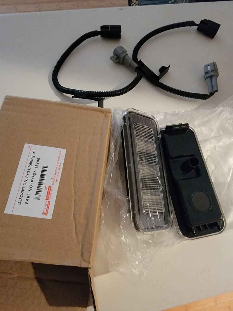

    FYI Anyone planning on using the oem. If it looks like this when you get it, it's fake. I ordered one on fleabay listed as genuine, twas not!
    Returned this garbo and ordered from a dealer the second time, learned my lesson being a penny pincher once again! Just to save $4... lol

    I went and bought a kit from a vendor on eBay, which clearly showed photos of a Toyota Box w/the P/N and such.
    When I received it, it wasn't what was pictured, and was in fact a Chinese copy, which I immediately sent back.
    The Chinese product could have say the wrong wire gage, or may be miswired, thus possibly causing damage, which I'm sure Toyota may not cover, or it may be just fine and work perfectly.
    Remember you own a 35K to $45K truck, do you really want to use cheap Chinese parts on it?
    I went and ordered a kit from a Toyota Dealer, including the switch.

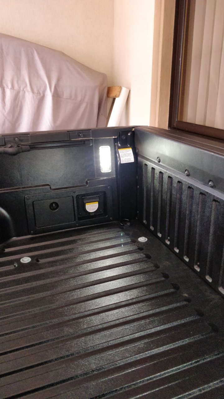

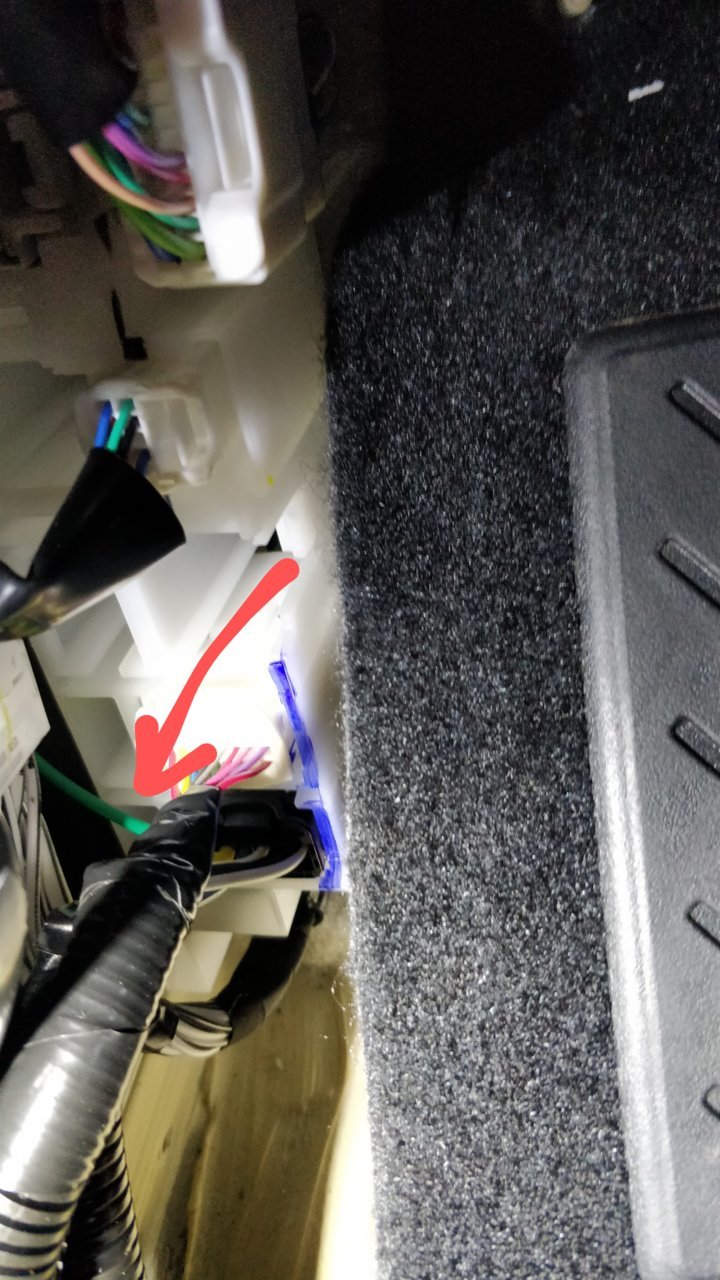

    Got my LED Bed Lights (Toyota OEM) installed today, went and ordered the needed Bed Light Switch (Toyota OEM), popped out the Switch Panel on the lower left of the dash, removed the blank off plate, and popped in the Switch. The relay switch is already there. The mating wiring plug for it is right below where the switch goes, in a dead socket. Pop it out from there, and into the switch. I turned it on, and voila the Bed Lights came on.
    You can either have them come on w/the door lights, or simply do it manually, shutting them off when not needed, w/the positioning of the switch settings.
    A very easy upgrade once you learn what is needed for the upgrade.
