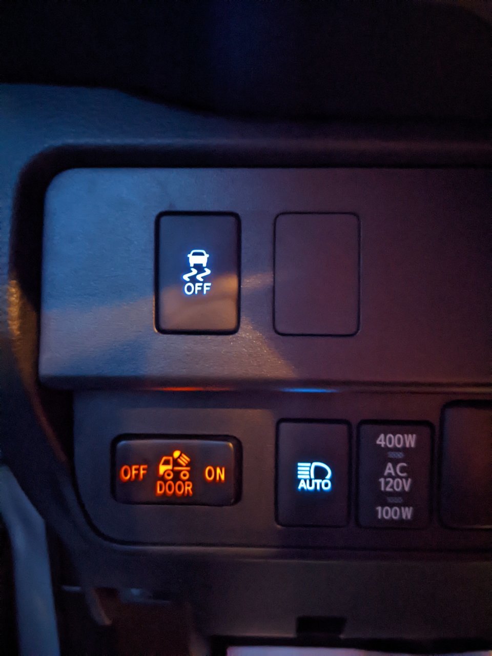

    I picked up the older switch off from eBay and it works great but it's orange instead of the bluish-white of everything else. Is it possible to change the color by swapping out LEDs or something?

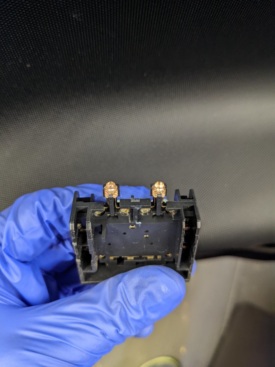

    Nick
    It comes apart easily and the LEDs are tinted
