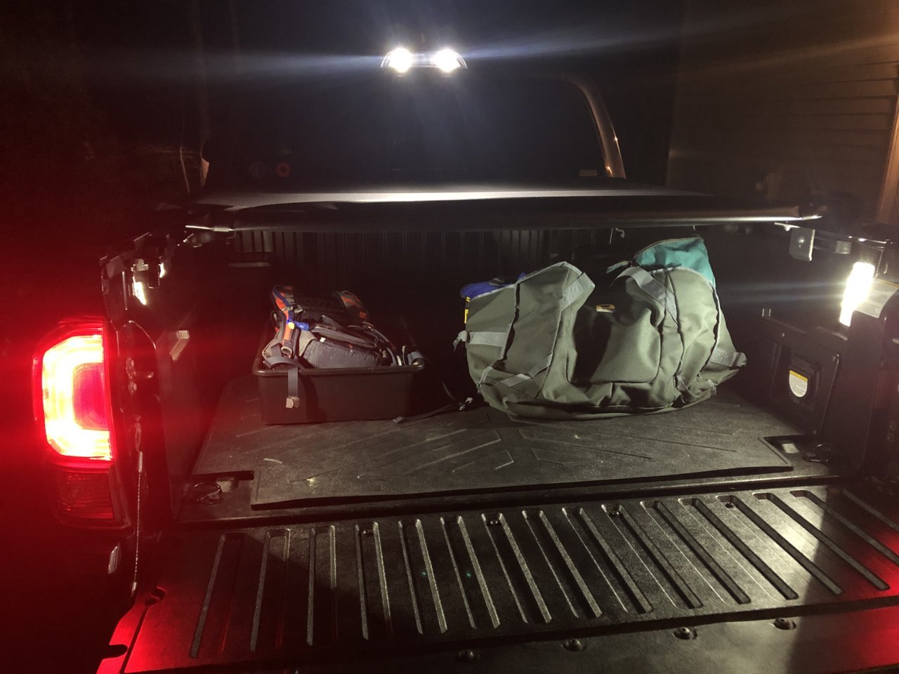

    Picked mine up from the dealership yesterday for $65. Installed in about 20 min. Totally worth it.

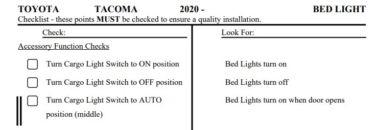

    Check out the instructions on the link below! I plan on installing some on my SR and spent a day just trying to figure out how to install the switch and relay. Check out #7 and #8:
    https://drive.google.com/open?id=1ATITd6gBES0rQTjq0oCl0P9wVEK80xcU

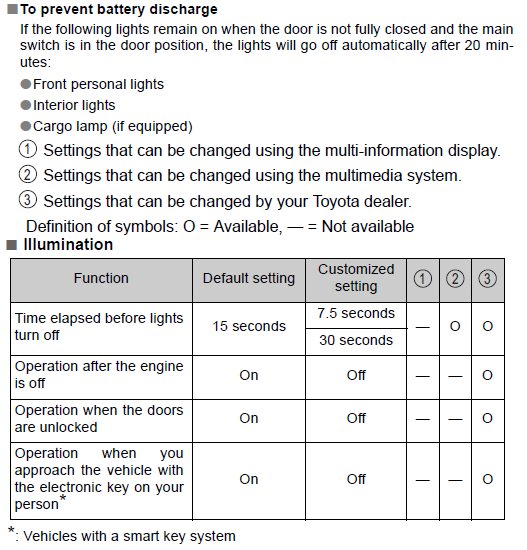

    On the 3rd Gen if you leave the cab illumination light on (parallel circuit to the bed light), the system cuts it off after 20 min.
