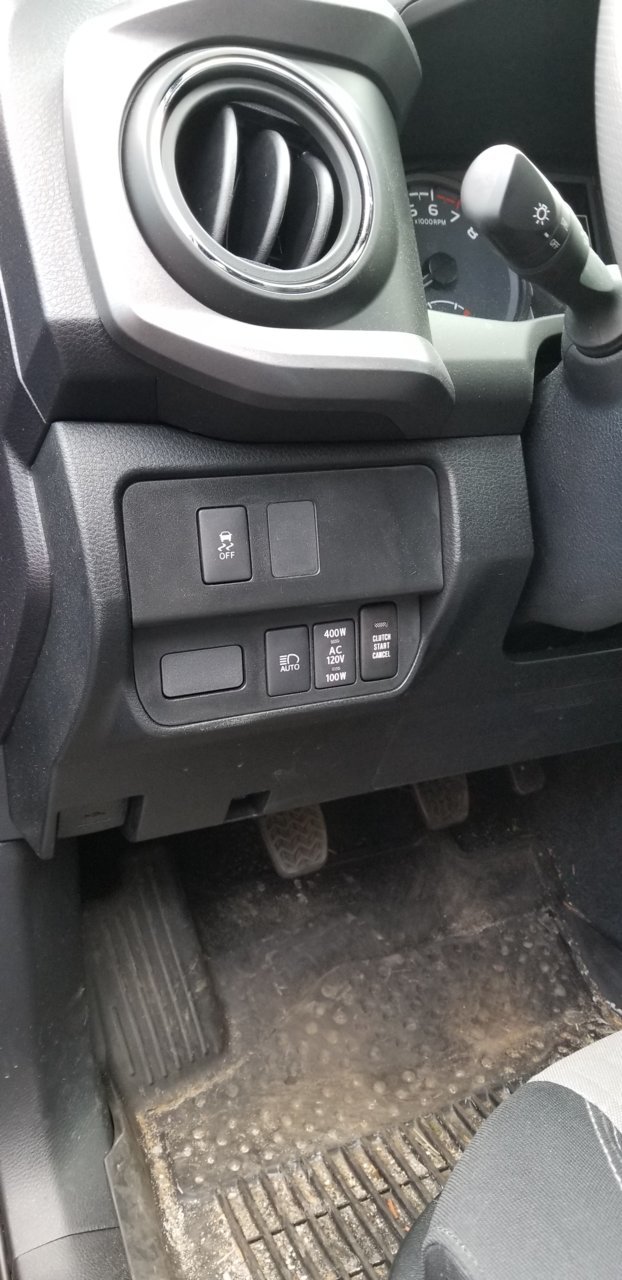

    Here is what us access cab owners have.20200422_162623.jpg 20200422_163245.jpg

    I wonder if you could potentially hook it up to the dome light switch above your head. Anything’s possible I guess but makes my case for @mattgecko

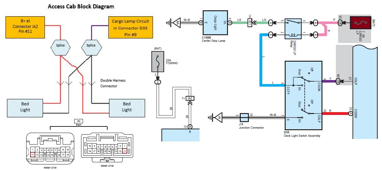

    Thank you. My truck did not come with a switch, but had a blank in the location of the switch. I did figure it out and will post to show what to do.
    3rd Gen Access cabs without the 3rd brake light bed light can install it and need the switch to turn the bed lights on or off. A 2020 sport Access Cab only needs the light kit, the relay, and the switch and the rest is prewired and ready to go.
    Edit: I uploaded my pictures to an album and will link here for access cab people to use (as soon as I figure out how to link an album...:eek: Here are my albums. I have included notes with the pictures. FLJB
    The install instructions with part numbers are in my post above (perhaps previous page post #90 Page 5) and that lists the parts to buy. Then you remove the panel and the blank and put in the relay and switch and use the prewired plug in a secret location and you are good to go!
    Easy and cool Covid Mod to do!

    Did you search n find where the bed wire attach to the cargo light wires?
  8. Apr 22, 2020 at 3:57 PM
    #108
    FLJB
    FLJB Well-Known Member
    Mar 27, 2009
    #15235
    294
    J
    FL
    2020 4X4 Sport MT
    yes, if you click through the album pictures, it has notes on them... The prewired plug that attaches to the switch is in a blank behind the panel you pull out. Unless you are talking about in the bed, those wires are behind the tail lights and my post earlier or previous page has the install instructions from the TIS that has pictures and everything to show where the wires in the bed are. hope that answered the question.:confused:

    Nope...the wires that the 2020 already has routed into the cab from the bed lights. It joins the wires that provide power to the Cargo Lamp (you don't have), that junction is my question...
  11. Apr 22, 2020 at 4:06 PM
    #111
    FLJB
    Mar 27, 2009
    #15235
    294
    J
    FL
    2020 4X4 Sport MT
    I am not sure I understand what you are saying... but, no I do not have the cargo lamp. I installed the lights in the bed, installed the relay and the switch that i bought and the switch controls the bed lights, off, with doors or on. No cargo lamp needed. The relay and switch are what allows it to work despite not having a cargo light.

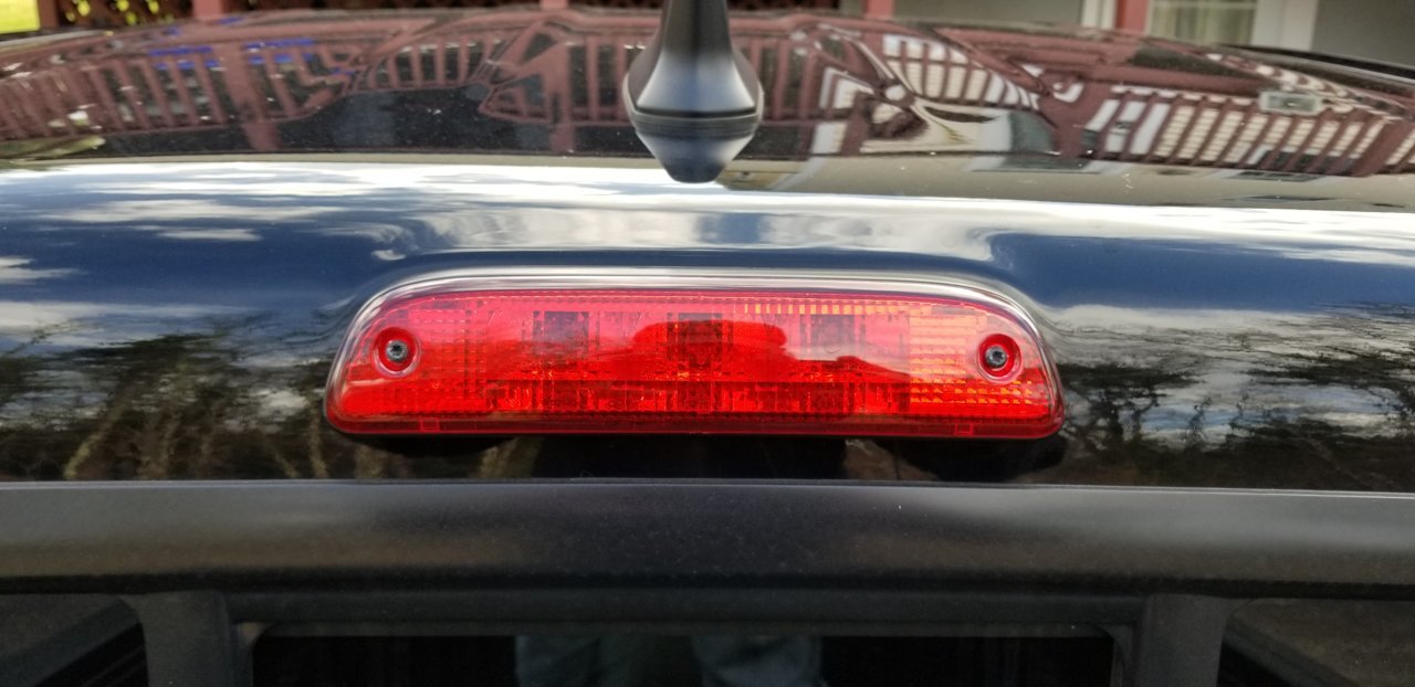

    Does anyone know how to install 3rd brake light cargo lamp? Not that I have the switch and relay I wanted to know if I can install a 3rd brake light that will light up the bed (white lights) when I use the switch? I've seen them on Ebay for $15. Does anyone know if they are just plug and play?
    Incase anyone was wondering, apparently the 2nd gen 3rd brake lights work for the 3rd gen access cabs.
