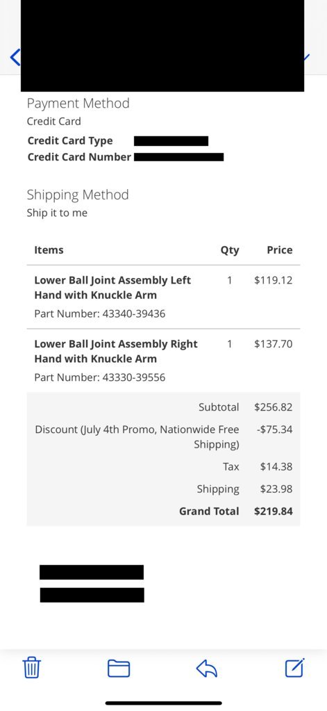

    All six lug gen1 are the same. I just did mine about three weeks ago and here is the correct part numbers.
