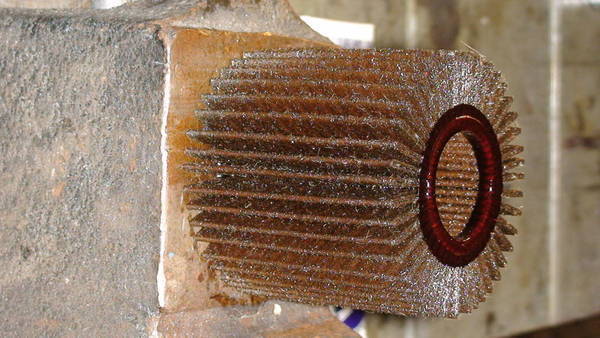

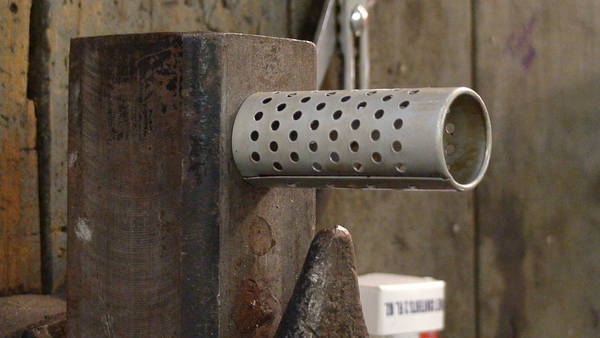

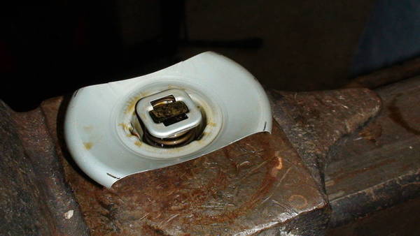

    So I changed my oil today and went a little over the recommended interval. I decided to see how the filter was holding up at 6,000 miles and I was quite surprised by the shape the filter was in at 6k. The filter was in great shape with all key components still going strong. The actual filter element its self held up great with very little wear, along with the glue that holds the element together at the top and bottom of the filter. The check valve and diaphragm was also in good shape with plenty of life left in them.
    Here are a few pictures of the Element, and check valve.
    Anyways, my conclusion after taking the filter apart at 6K is that the OEM filter is definitly worth its money. I would say it is right up there with the Napa Gold filter (wix).

    I use the napa gold filter. So based on your pics where is the best place on the filter to install magnets on the outside of the filter?

    If you were going to install magnets on the outside of the filter to help stop metal particles that are flowing into the filter element, I would install them about a quart to half inch from the top of the filter (top being where the filter mates with the housing). That way the magnets would theoretically stop the contaminates before it went into the element. Albeit, in normal circumstances the amount of metal contaminates that will go into the filter in the first place is quite low.

    Some filters do come apart and one way to find out is what this guy did. I put a lot of weight to the visual inspection. Some times you dont need an oil sample to satisfy your curiosity. I dont think he was giving his stamp of approval, just that he was curios and took the thing apart and this is what he found.
