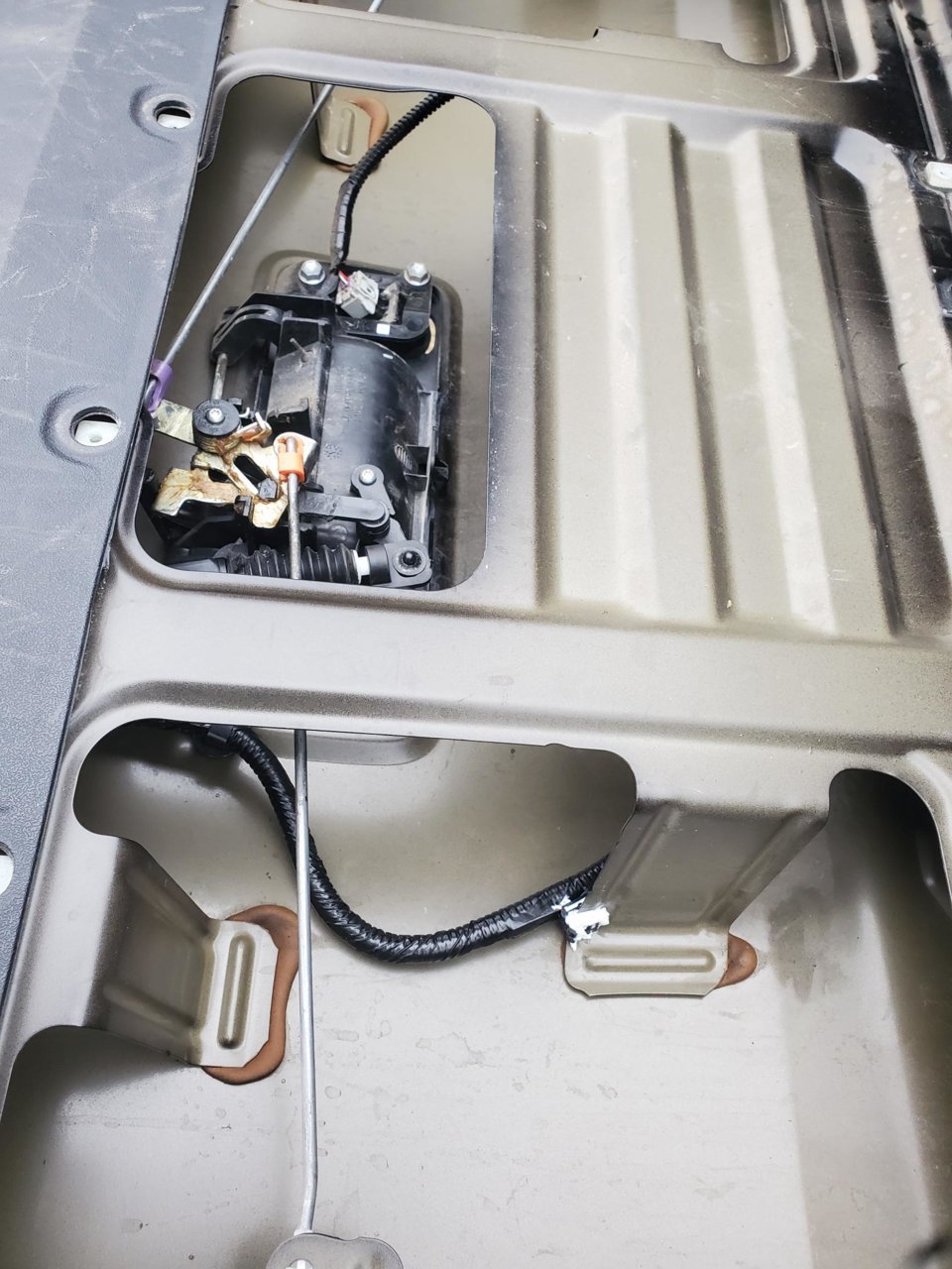

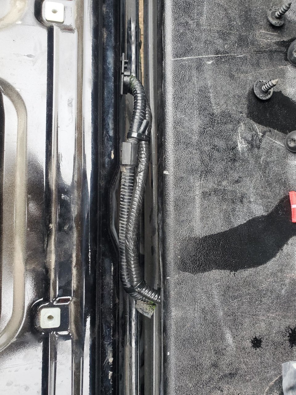

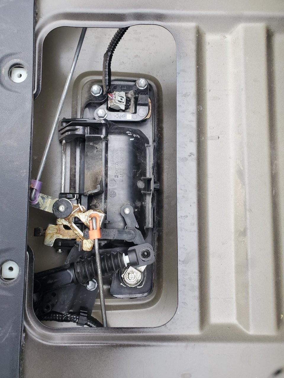

  6. Nov 25, 2021 at 2:23 PM
    #46
    r81984
    r81984 Active Member
    Jun 13, 2021
    #368533
    40
    2017 Black Tacoma TRD Sport 2WD 6cyl
    I just installed on my 2017 Tacoma TRD. Took about 2.5 hrs. I highly recommend it as now my tailgate locks and unlocks with my doors. Something that should have been standard.
    The instructions from Toyota are pretty bad. The pictures are printed with a potato and they dont say the correct orientation for the lock cable and the camera cable between the tailgate and the body. Just had to figure that out.
    It is not difficult, but takes a while. The hardest part is trying to squeeze the cable under the carpet and out the hole under the seat.
    I bought the Toyota tailgate actuator kit on Amazon for $152. It has everything in the kit except a tube of sealant and a tube of grease.
    You need a T30 torx and 10mm socket. The trim just pops off.
    I did use a set of shears to cut the excess off the metal zip ties.
    I used some RTV silicone for the clip and just some regular grease on the actuator.
    I did put some Locktite blue (removable) on the bolt that holds down the actuator as I did not want it to ever come loose.
