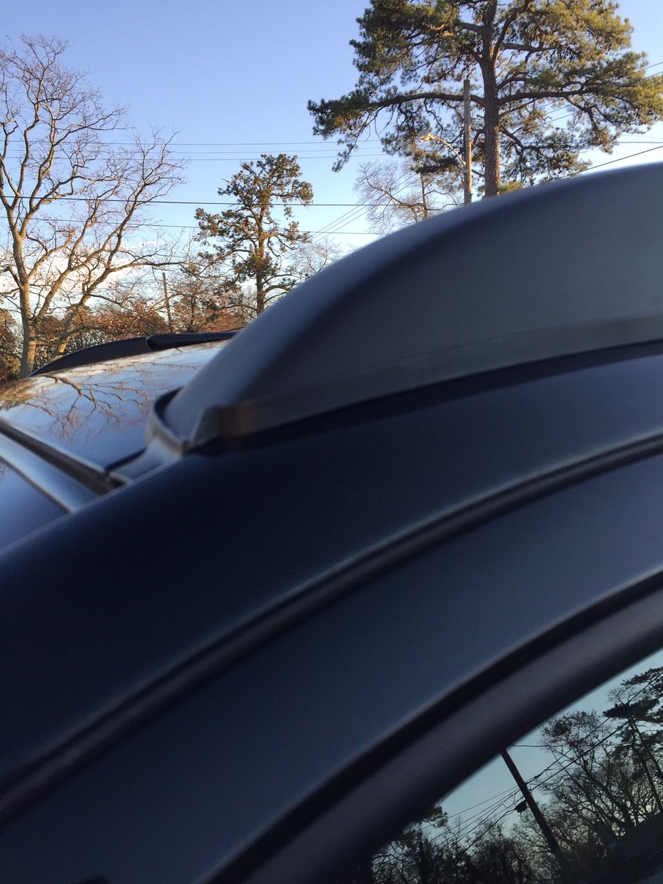

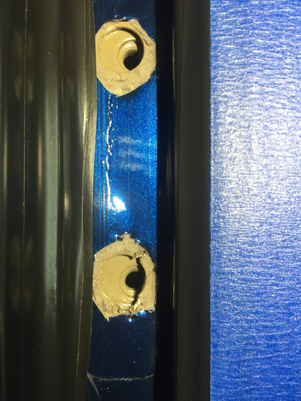

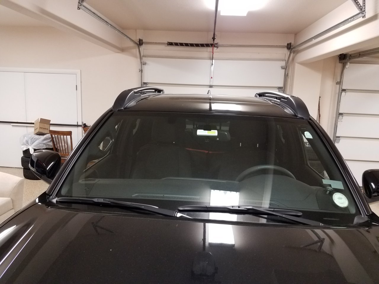

    Just installed my roof rack. I got it from Toyota for about $300. Installation went pretty smoothly. A couple screws game me some difficulty. They felt like they were going in cross threaded, eventually going in straight. Also, the rack on the right side wouldn't line up with the holes in bracket, despite using a awl to manipulate it into position.
    I manged to not have a gap on the driver side like some have complained about, without bending the left bracket. I'm curious if the reason for the gap is the yellow clip being installed on the bracket instead of the rack. The clip slides sideways into a slot on the roof rack. So if your clip was installed in the bracket first, it would not be able to connect to the roof rack properly with downward pressure. It would actually push the rack up.
    I took it to the car wash and didn't find any leaks yet. Hope it stays that way. I did use some marine/auto sealer in the holes prior to putting the screws in.

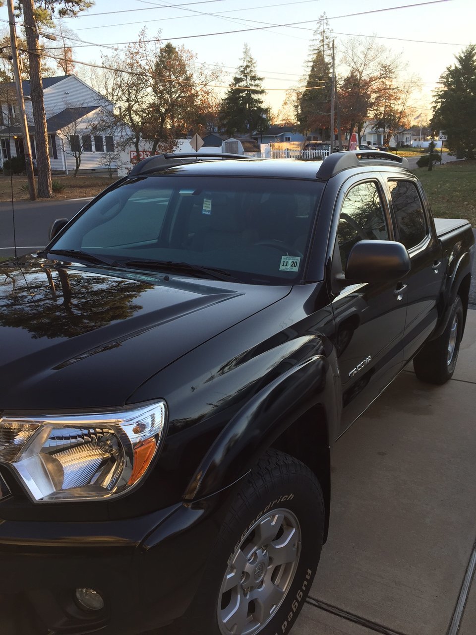

    Got mine installed, similar issues as Arthur Vandelay
    Slight gaps on both sides at the front that I couldn't get any tighter.
    As always, thanks to all the great info on this site.
    I only had adhesive on the very back curved surface of the original plastic strips, same area that rack uses tape.

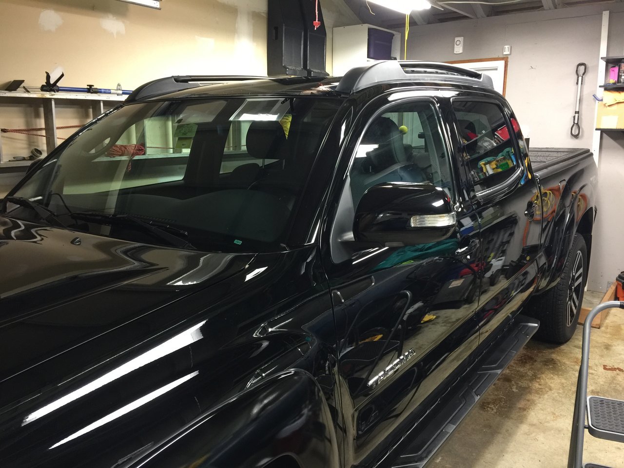

    Installed mine, might have paid the dealer to deal with this poor Toyota quality. The weld nut plates were welded so far off center from the holes on the roof sheet metal that I had to use a die grinder to open it up.
    Then, once that was done, the holes in the rack brackets wouldn’t align, so I had to mill them into slots to even come close to bolting up.
    One trick I found with the yellow clip is that I had much better luck installing it once I used 2 zip ties to hold the clip in place on the underside of the roof rack, this helped me maneuver it into place and align the other center and rear mounting holes without the clip sliding out of the rack slot.
    Overall I had no gaps and no leaks. Very happy with the look and can’t wait to use them!

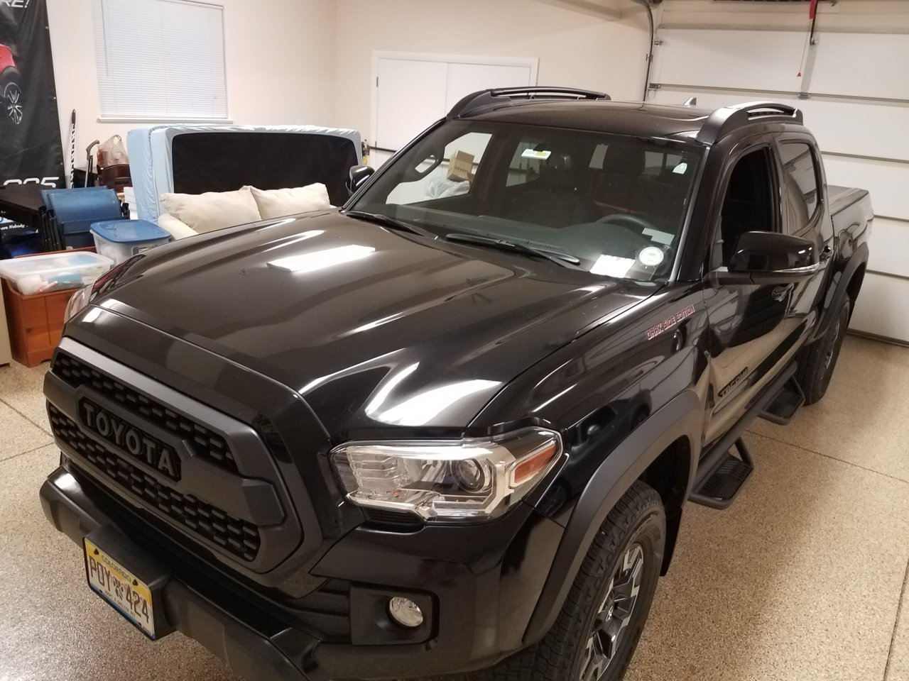

    Update on my rack... take in account that this is the 2017 3rd gen, but there wasn't a post for my model.
    The rack looks great and operates wonderfully! However, I wish I had gone through the dealer for the install as the left side leaks into the B pillar. I'd heard about issues with the A pillar and water, but I'm getting water in the seat belt compartment. I'll have to take off the rack and try to seal it up better. Had I gone through the dealer, they would be dealing with everything. My mistake.
    Here's some pictures for reference on the look.20180612_201342.jpg 20180612_201334.jpg

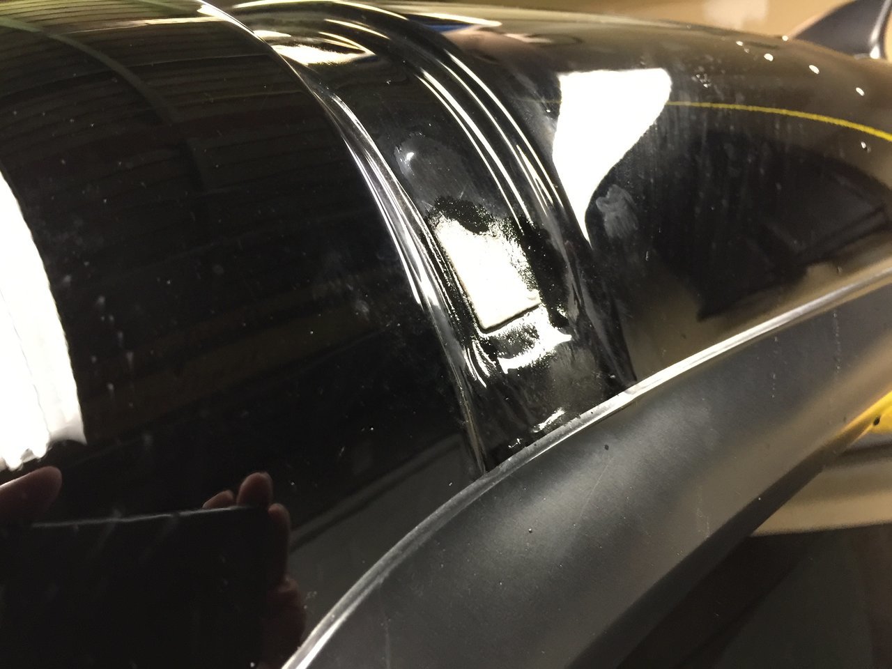

    So I just installed the OEM rack on my 1 day old 2019 TRD Off Road Double Cab today without instructions (watched 2 YouTube videos...didn’t find instructions til now) and overall it went fine. One bolt took a little work to align, but eventually was fine once I loosened the rest and pushed the rack more to align.
    The plastic molding of the rack appears to fit snug against the truck roof, but I never broke off the sides of those front channel tabs noted in the actual instructions since I didn’t know about that step and now I’m wondering if I need to. Does anyone think I need to break those side tabs if it is fitting fine? I’m assuming no. The YouTube videos I watched didn’t do it.
    Also, the very front rubber that fits in the channel in front of the rack on one side sits about 1/8” back from the windshield rubber (other side is touching). Does anyone think this will cause an issue? I’m thinking water is meant to run down the side of the windshield from the top. I took the rack and bracket back off to see if I could pull it forward, but it won’t go anymore forward. I almost screwed myself with that yellow insert, but managed to reuse it.
    Lastly, I only used the foam washers and now have some concerns of future leaks after reading the thread. Are the leaks easy to spot? I hate to have an ongoing leak that isn’t noticeable until something is damaged. Is it worth taking off and putting silicone around the hole? The instructions don’t mention a silicone.
