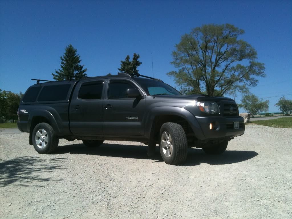

  15. Jun 2, 2011 at 2:05 PM
    #35
    Cicatrix
    Cicatrix Member
    Jul 17, 2009
    #19780
    5
    Toronto
    09TacomaDualCab TRD LeatherSeats MagneticGrey
    Did mine last night, some gap i will be looking into sealing somehow, maybe some silicone if it won't damage the finish
    needed the rack to do some camping this summer and I hate the thought of having a foam wedge jammed between the roof and a canoe
