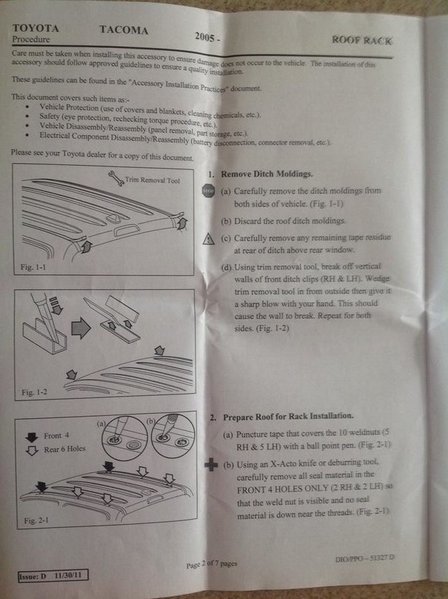

    For those that did not have a gap on the drivers side. Did you have to break the vertical tabs (see post 45)?
    Are those tabs used for the OEM trim molding?

    Yes, I broke the tabs. No gap here. I figured the roof rack is permanent so what the hell. .. :)
    Gave away my roof strips too. .. there is no going back! Love the OEM rack!

    Mine did as well... it was a nightmare. Some bolts went in like butter, others were kind of tough and then on the passenger side, the middle bolt won't even go in.. at all...

    The install went well on my truck, no gaps, did have one hole not threaded right in the front bracket itself, had to force it, was not straight, had problems with yellow clip on one side and when I screwed the that side down to the front bracket it pulled the whole thing down. Not too bad for a DIY. Took a couple of hours maybe three.

    Couple of questions for you guys...
    I read somewhere that 2012s don't have the bolt holes for instillation. Can anyone with confirm or deny?
    Second question has anyone had water leaking issues? I read before some people using silicon or plumber's tape. For those who did, where did you use them?

    I have a 2013, it was completely fine. Although the fit and finish if far from perfect I have zero leaks and I just screwed it in, nothing special used.

    I have a 2012 since new. installed mine shortly after buying. They do have bolt holes and no leaks.

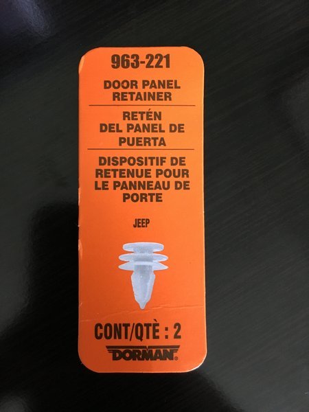

    Hello all.
    I have found a replacement yellow faster for the OE roof rack. It is not exact but it fits into the notch in the in the roof rack itself and the hole on the mounting bracket.
    It is from Dorman, part number 963-221.
    Hope this helps,
    NP
