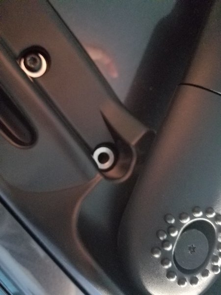

    I just installed mine Sunday. Had the same problem with holes not lining up. First holes that didn't line up were the drivers side bracket. Ended up having to make one of the holes in the bracket bigger. They are very unforgiving threads, if they don't line up perfect they won't go in or you'll cross thread either the hole or the bolt.
    Finally worked, but in the process of of lining up the final holes (from your pic), the front clip popped out. Now the drivers side has the infamous "gap" up front. I'll need to get a new clip and re-do it, maybe this weekend. But terrified to unscrew it, and risk cross threading starting all over.

    How big was your 'gap' do you have pics? I have a couple very small ones but not sure they are really of concern...interested to know how your gaps looked.
