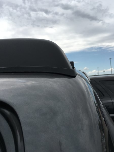

    I'm just curious cause I bought a "genuine" OEM rack off a Toyota parts dealer through Amazon, and looking the part over, I just can't imagine it's a real OEM part. I'm trying to figure out if I got sent a cheap Chinese knockoff or not. Toyota isn't in the business of producing parts with this poor of fitment. No OEM manufacturer is.

    I did mine today. No problems at all on drivers side. Right hand side is completely f'd up. The bolt for the passenger side that holds the ball joint every time I try to screw it in the nut on the inside pops out. Only way to get it is remove the entire thing again then tape it in place so it doesn't happen again. Second time the two shortest screws they hold the plastic to the bracket near the ball joint completely stripped out. Not sure what the heck to do about now.
    I will probably have to go pay the dealerships to fix.

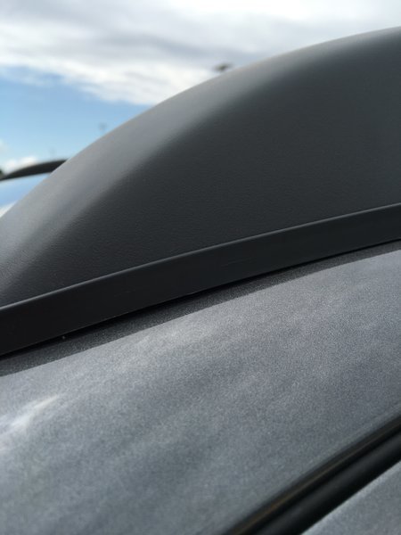

    What I think is amusing is the Toyota instructions say no gap should be more than 1.5 mm, (0.06) inch, which I believe is laughable and impossible given the design and manufacturing process of these

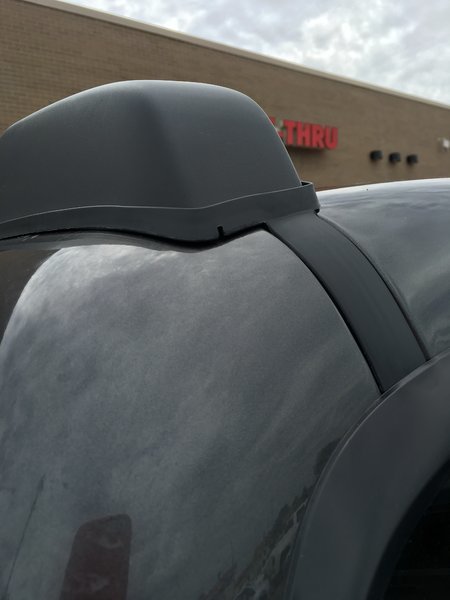

    When I first installed mine I had trouble getting that yellow plastic piece into the bracket. I need to redo the entire side and now it's even worse. I've even had to retap 2 holes cuz the bolts would thread in after taking them out. This is turning out to be a huge pain in the ass.
