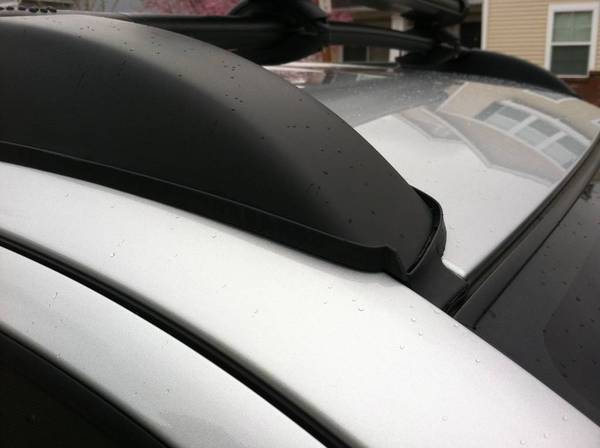

    Thanks for the info matts. The gap on mine looks just like yours, I am just going to leave them alone. The more I mess with it the worse it will get I am sure! I will post some pics after I install my new Yakima Fatcat 6 on the rack tomorrow evening.

    Yeah I would not mess with it. It is not doing any harm and the only person who would notice it is you. Post those pics!

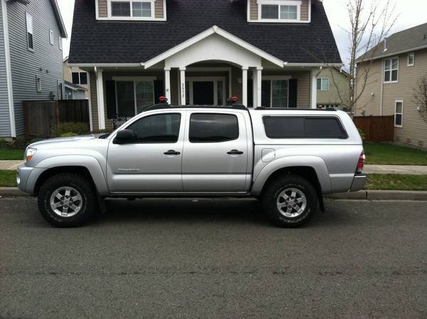

    Here are a couple of pics from my recent install. OEM Roof Rack with Yakima FatCat 6 . . .
