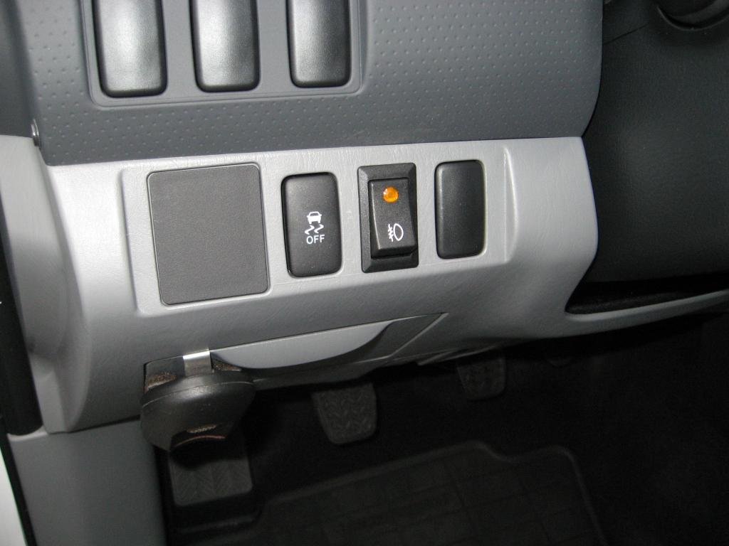

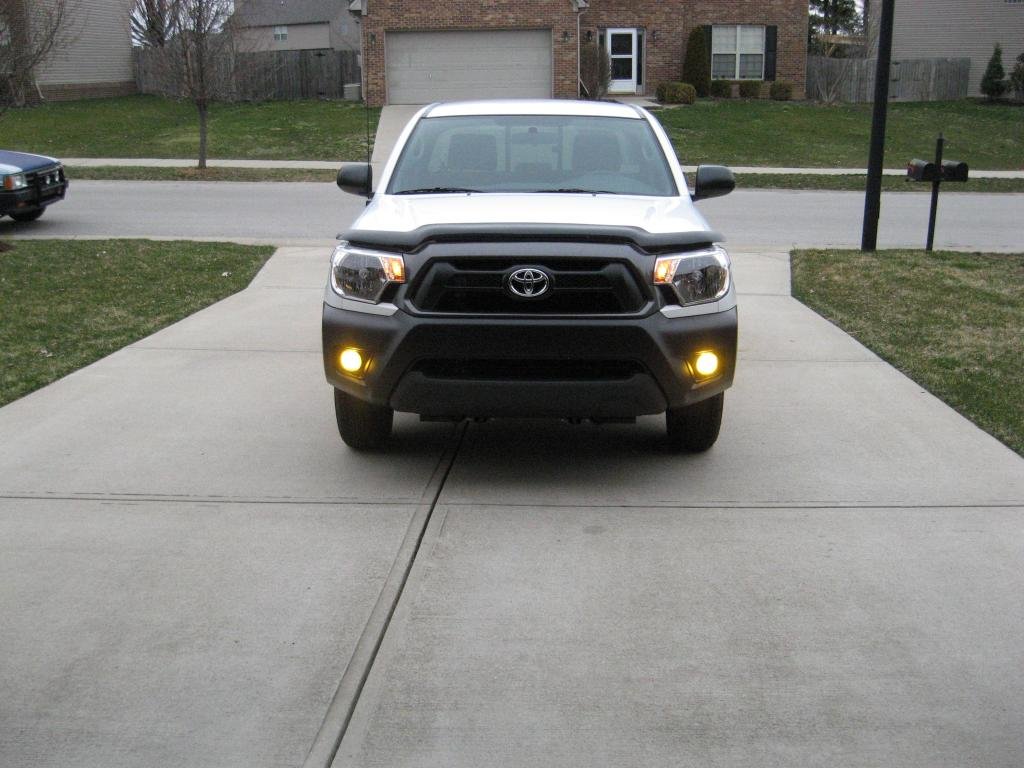

    I purchased my kit for my 2013 RC from my dealer, it's a SET part number, South East Toyota, FWIW
    Comes with factory lights, the harness and relays they put together for you and a cheap switch that fits, it isn't back lit, but it does light up when they are on.
    Hoping to install them this weekend,
    Paid 154.00 for the kit,
    The PN for any interested is in the pic,
