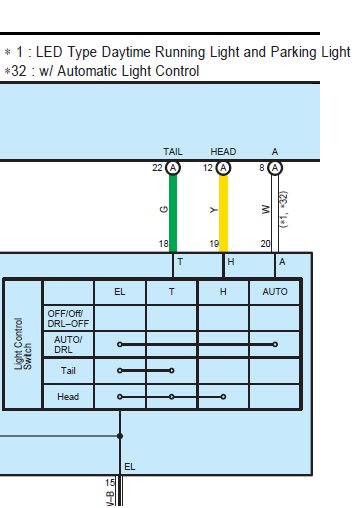

    Difference is the AUTO feature. Since your TACO didn't come with that feature, it most likely does have the DRL feature. If so, Auto position would duplicate DRL position on the different part number. (as in AUTO = DRL ON)
