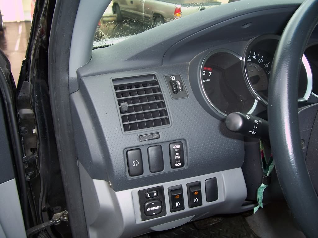

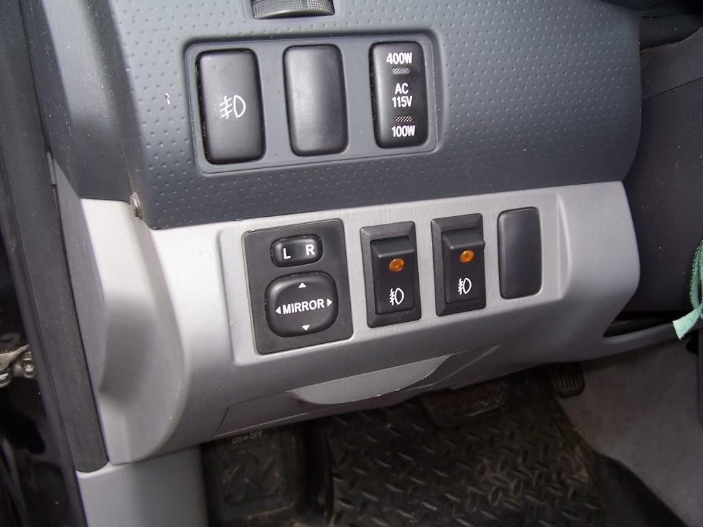

    A few bolts are different.
    It wont with without dremel tooling the inside of the hole where the knock out originally was, the stock toyota switches p/n:00550-35976 I installed last night had the same problem. when you take out the knock outs you can see how the holes are notched to fit specific switched like traction control and locking diff.
    100_2401_41975f1fc9f4c3fee4cb72d67fa3d2e5145aae96.jpg100_2402_32311589ff32c0d3433243bd681a494d3f566549.jpg
    14.00 bucks at the Stealership. only difference is the new stock has the small round light

    At your dealer. My dealer had them in stock!! p/n:00550-35976
