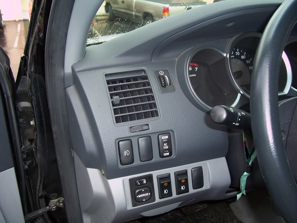

    3 some on the switches #1

  13. Oct 7, 2008 at 9:36 AM
    #33
    longbow
    longbow I see you now..................
    Jun 26, 2008
    #7586
    4,029
    Bill
    Indiana
    05 Tacoma Silver Mica TRD 4 Door
    Toy-tec Coil over lift, Eibach 700 lb springs, Sway bar relocate, Total Chaos UCA's, Moto metal wheels, BFG mudterrians, HID, custom 3 piece grill, Highlift jack w/custom mount, Highlift jack cover, bed matt, de-badged 100%, storage box lock mod, using defrost w/o AC mod, short antenna mod, horn re-locate, Tire Gate flat spare tire mount, engine cover painted, bed light (1) mod, wreck bar carrier, Blue Sea 5026 fuse block, center console outlet, flash light mod, Blue Sea inline fuse, Shrockworks sliders, All-Pro front bumper, Piaa 510 driving lights, Warn shackles front, Kennesaw rear bumper, "Tag Boltz" plate lights, Warn shackles rear, Warn M8000 winch, devil horns, BHLM, weathech liners front and rear.....T.W. sticker of course. Custom Sock bed decal for Michele
    As you can see I mounted them upside down from other people. I had a hard time seeing them when on. For me this way works the best, but to each his/her own.

    That does look good Ill have two in I would like to install another, I just dont have anything els that needs a switch, YET:D

    ya, thought the same thing myself, but for the cost and fill a plugged hole, why not.
    I may go with back-up lights, but still need to look at a location.
    Trying to talk the wife into a bumper like yours with the winch, then one of the switches is covered use wise. But so far she is not buying it, maybe a x-mas gift.......hum:rolleyes:

    Cant decide which way i like the switches to sit in the off position better!
    OR
  17. Oct 7, 2008 at 2:14 PM
