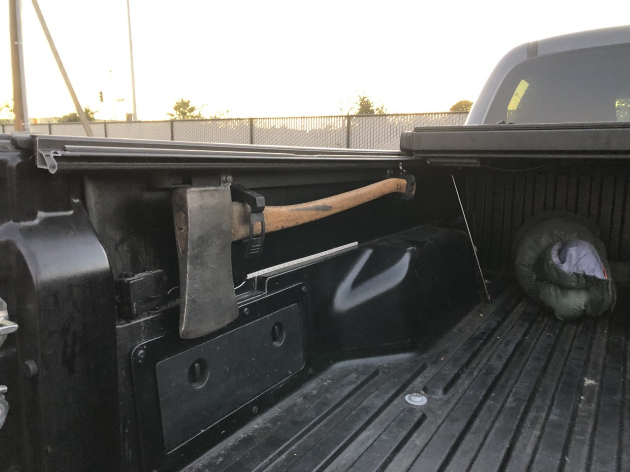

    I did something similar with the original quick fist mounts. I just used a drop down hanger from depot and stuck a 1” wood block behind it to give it some added stability. I used the existing bolts from the tonneau cover and went through the bracket. I’m going to make some revisions though and use threaded Riv nuts to bolt it directly to the bed. Not sure if this helps

    Yes, that helps! I was really thinking about the two holes behind the cab that are there for the OEM tonneau. I like that setup too, and I may try the same with the splitting maul. Appreciate your help.

    Mine is the OEM cover.
