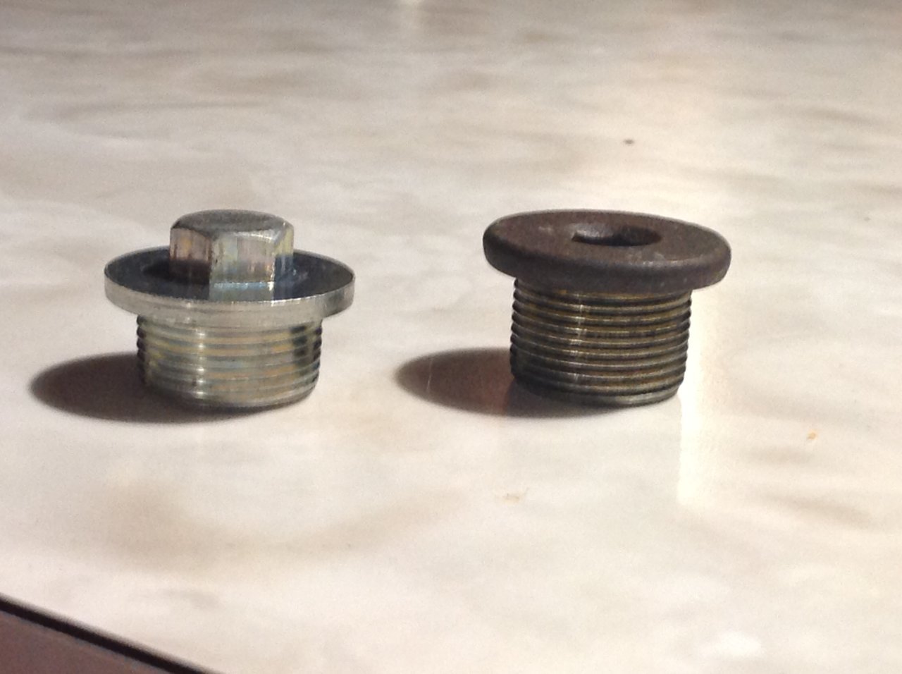

    One last thing - when you're doing the front diff, you might consider replacing the drain plug with one that uses a 14mm hex head, rather than the OEM 10mm allen key. For me at least, it makes removal much less stressful.

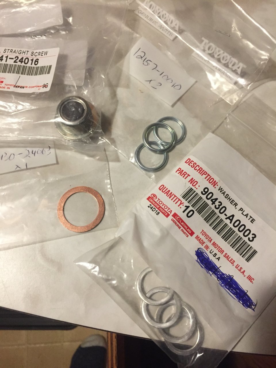

    Yes, same washer/gasket for 1st gen and 2nd gen in this regard. I generally find that I can reuse the crush washers on the MT, but if you want to replace, the part number you are looking for is 90430-18008/90430-A0003, and you need two of them. You could get this kit, which will do the front diff, rear diff, transfer case, and MT.

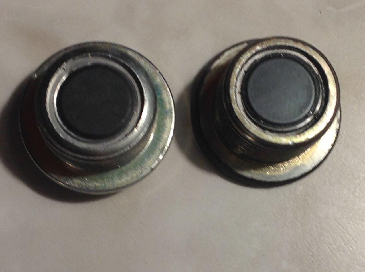

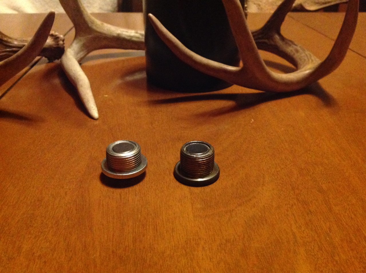

  16. Feb 29, 2020 at 5:59 PM
    #16
    ontarioyota
    ontarioyota Well-Known Member
    Oct 2, 2010
    #44122
    1,330
    @scott777taco INSTAGRAM
    SW Ontario, Canada
    2001 Reg Cab 4x4
    Blacked out badges-rims OME lift with 881's & dakar pacs, summer tires=BFG 31x10.5x15 on 93 4runner rims,winter= 265 75 16 DURATRACS on stock steelies,Flowmaster exhaust, deck plate mod, ARB front bumper
    I was able to source all the goodies from the parts girl at my local Toyota dealership.
    The hexhead front diff. replacement plug was certainly shorter by threads and the magnet was not as strong as the stock OEM plug.
    I had no issues getting the stock plug off.
