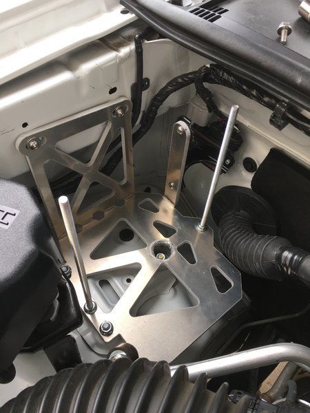

    Since the last thread posted about our systems is almost a year old and the products and company have evolved immensely since then, I thought I would open up another discussion pertaining to our battery systems and other power products.
    While the old group buy thread (available for your viewing pleasure here) has a ton of good info, it also has a lot of old info.
    I also thought this would be a great place to drop off the installation diagram for our most popular kit. I get asked for it A LOT. So, this may be a convenient spot for it to be stored for reference.
    Here is a clear view without the instructions on top.
    For the space conscious. We also offer a "side-by-side" kit.

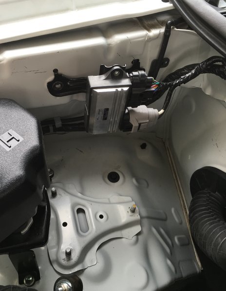

    in the location of the second battery tray - 2015 offroad have a little device there.. like a small rectangular whatcha-macallit..
    how is that relocated?

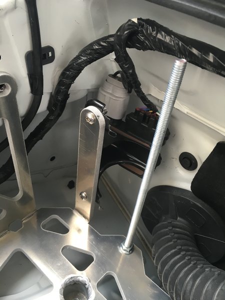

    Ah yes, the whatcha-macallit. Toyota calls it a "fuel resistor" and the OGE auxiliary tray has a convenient new mounting location built right in. The "fuel resistor" is unbolted from the fender, swiveled 90 degrees and reinstalled on the back of the new tray. No modification to the wiring is required.

    What benifit do you get by moving one battery to the passenger side? Just better weight distribution? Or is there more to it? With the price difference between the two kits, placing both batteries on one side is quite appealing. Plus you can retain that passenger side area for a compressor. P

    Valid question. The "split kit", as I like to call it, definitely provides better weight distribution as major advantage. The Tacoma already suffers from chronic "driver's side lean" and adding an additional 40-70 lb battery does not help. The split kit also allows the installation of much higher quality, higher amp/hour batteries because of the weight distribution. For example: Placing two Odyssey PC1400 batteries side by side would be approximately 115 lbs of battery on one fender... which, in extreme circumstances can lead to sheet metal fatigue. For this reason, we always recommend Optima batteries for side by side installation. They only weigh 35 lbs a piece and are lower profile. However, this sacrifices 34 amp/hours between the two batteries.
    Ok. We've beat weight distribution to death. Why else is the split kit better? It is 100% bolt in. No cutting, splicing, crimping, drilling, or permanent modification to the truck is required, whatsoever. The side-by-side kit requires lengthening of the factory cables and drilling.
    All that aside, you are correct. If you need the additional space on the passenger fender, then you can't go wrong with the space-saving, cheaper option, side-by-side kit.
