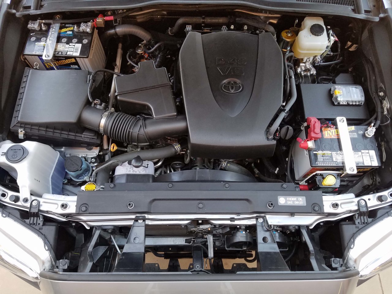

    Installed a Off-Grid Engineering 2 battery kit in my 16 Tacoma yesterday. Deka AGM batteries. Deep Cycle for the secondary battery. Easy install, quality product Matt puts together.

    NICE WORK!
