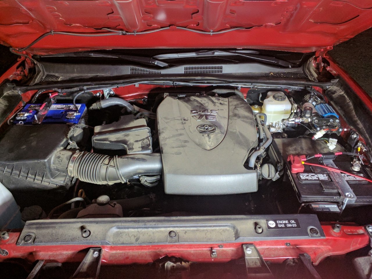

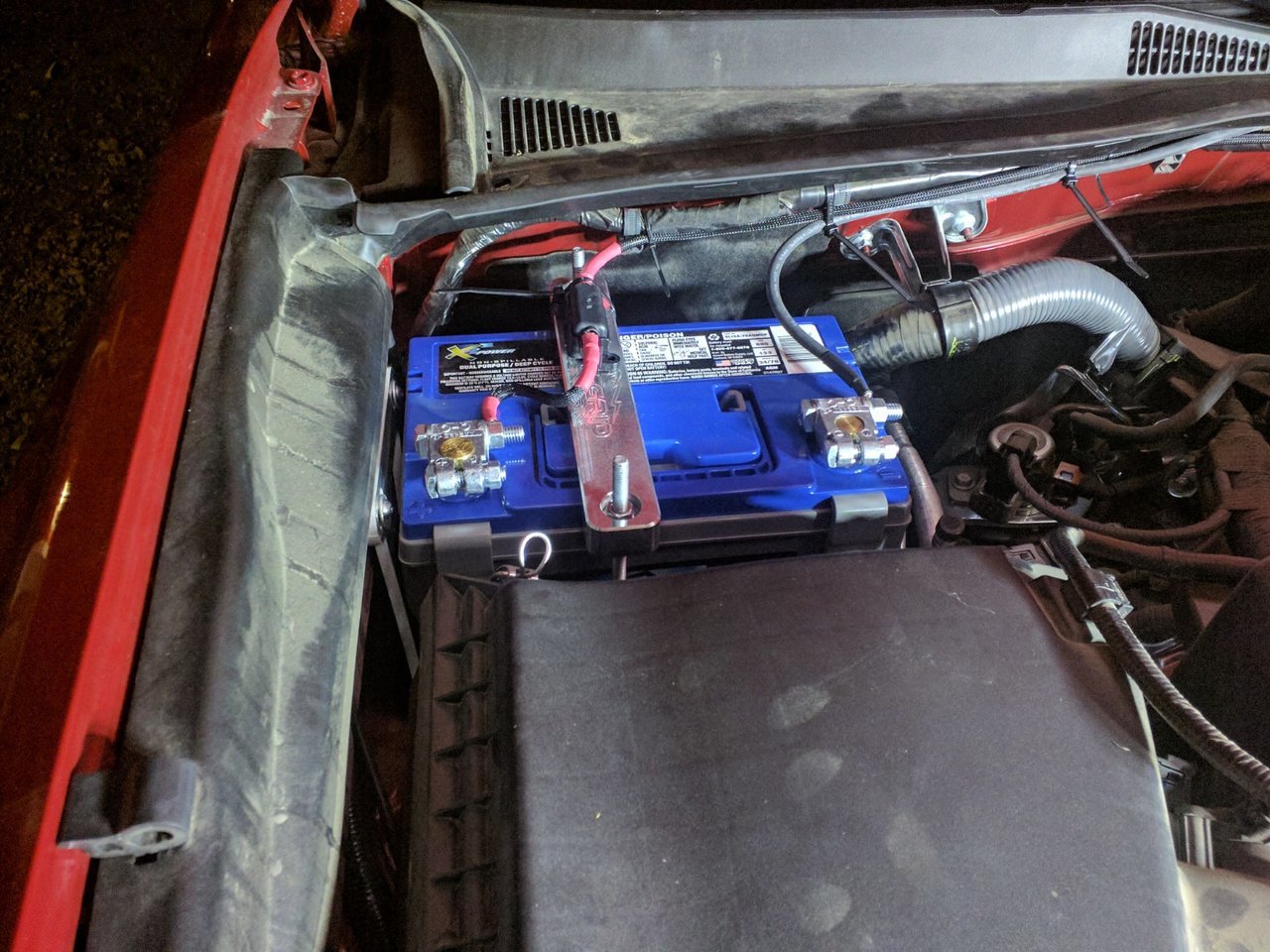

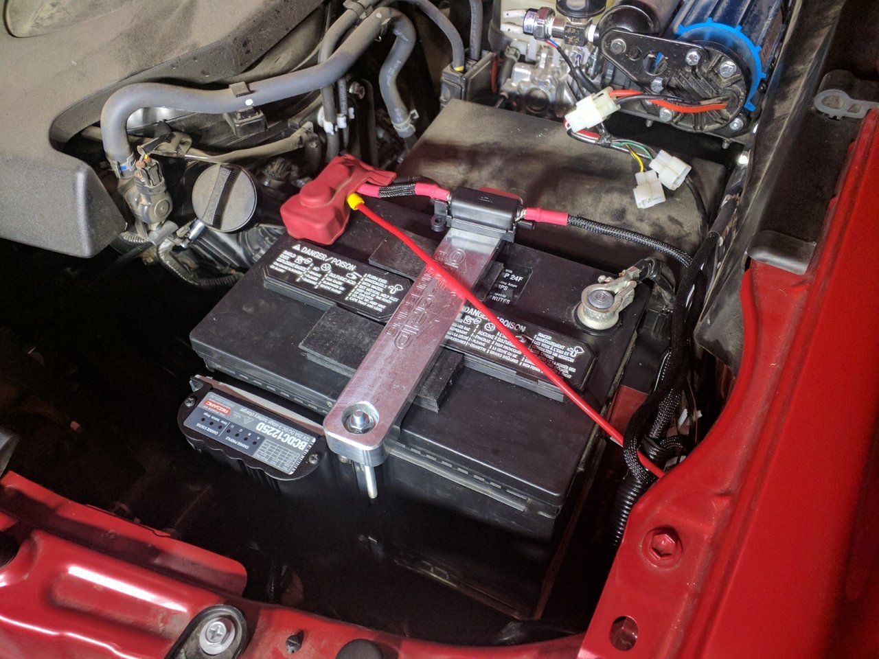

    @HeliMedic I finished the installation of the RedArc DC-DC Charger (though nothing hooked up to the aux battery, yet). Looks like ~13.8 volts going in, and ~14.3 volts coming out! Sounds like success to me! :D
    Q: Is it normal for the "A" profile LED to blink when the truck is off?
    Q: The included battery tie-down bar is not compatible with the stock battery. It doesn't fit between the raised covers on the battery. I had to use some shims I had lying around because the thickness of the battery tray means the stock tie-down no longer works. Any suggestions for something a little more "permanent"?
    Edit: Ignore the red wire on the starter battery - that's the wiring harness for the ARB compressor.
    Photos (sorry for the dirt):

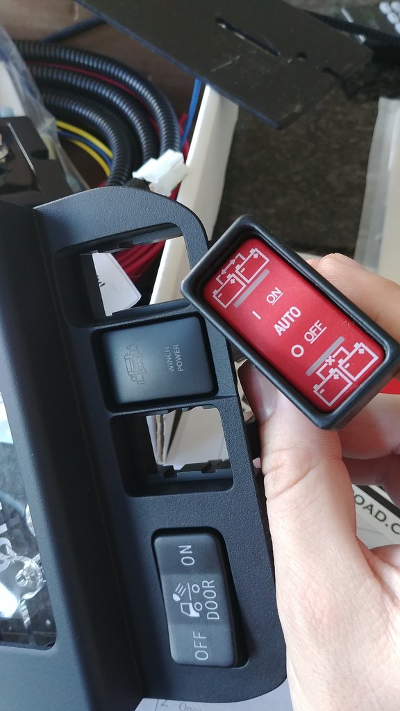

    3rd gen crew -- how is everyone mounting their battery isolate switch to the left side of the dash? Dremeling out a larger opening?

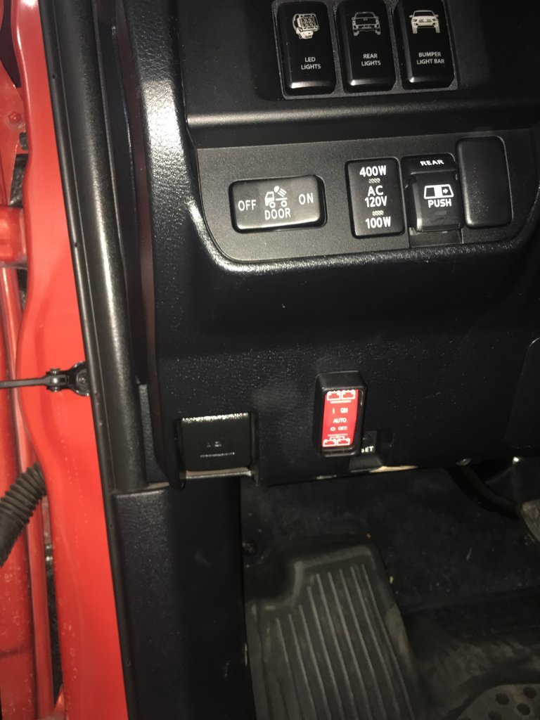

    Here is where I put mine.
